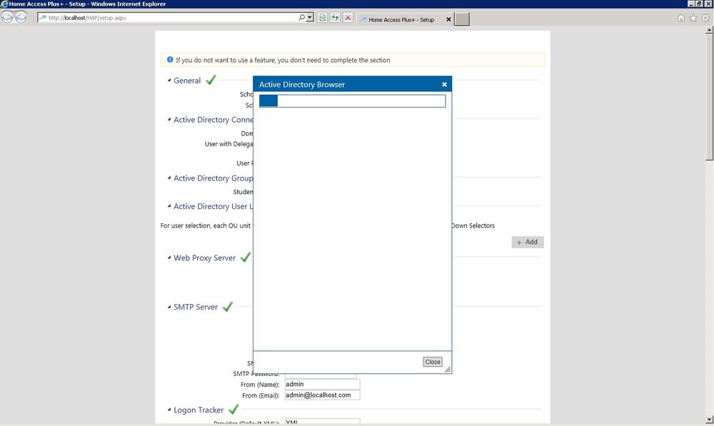

Hello, I am now able to access HAP+ Setup, but still getting some errors when going through config
When I enter AD details and click on Students Group I get the mst'Message From WebPage'
Then AD Broswer Appears as in 'Active Directory Browser'
[ATTACH=CONFIG]12440[/ATTACH]
[ATTACH=CONFIG]12441[/ATTACH]

I Installed this today and I cant seem to get past the System.ServiceModel.ServiceActivationException Error when trying to do the Active Directory credentials either.
When trying to put in a student group, the AD Browser is blank. I can log into HAP fine though.
I installed it on server 2003 R2 with IIS 6. Also followed the install notes to the "T"
Can you run the .net 4 Extended Edition setup from Add/Remove Progs, select Restore Details or Repair
