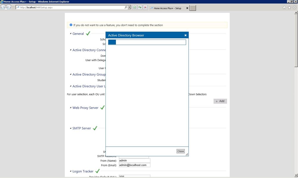

  9. Hello, I am now able to access HAP+ Setup, but still getting some errors when going through config When I enter AD details and click on Students Group I get the mst'Message From WebPage' Then AD Broswer Appears as in 'Active Directory Browser' Also when I press Save I get the following message Please help. Also can anyone point me to a config guide for 'Home Drives' etc. In our school we have two file servers for students, home drive paths somthing like \\servername\students\year\%username% How can I define this in HAP+????
  10. Hello, I am now able to access HAP+ Setup, but still getting some errors when going through config When I enter AD details and click on Students Group I get the mst'Message From WebPage' Then AD Broswer Appears as in 'Active Directory Browser' Please help. Also can anyone point me to a config guide for 'Home Drives' etc. In our school we have two file servers for students, home drive paths somthing like \\servername\students\year\%username% How can I define this in HAP+????

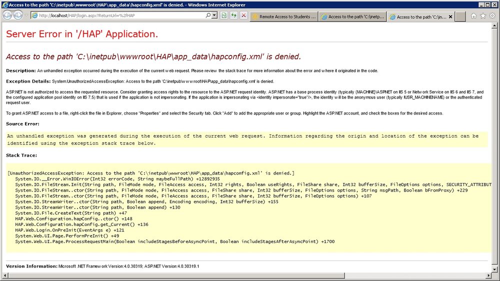

  12. Hello, I am working through v7 Documentation for setup on IIS7. On step 34. I get an error msg as in the attachment 'Mime Error' Also when I try browsing to the application / website I get the an error as in attachment 'Application Errror' Please help.
