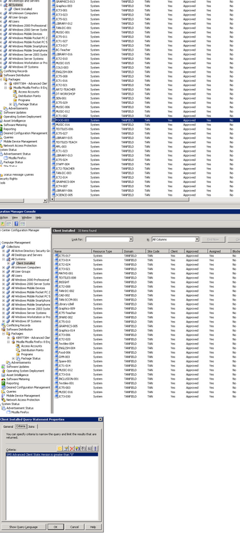

I installed SCCM and pushed the client out and it installed on all machines. But the install had a problem so I went through again with a new SCCM install. Now when trying to push the client out, nothing happens. The console reports that the client is installed, but I have a seperate collection that only populates with 'v0 or higher' of the client, and this only lists 33 computers.
I know I'm not explaining this very well, so I've attached a screenshot to help further explain.
It shows:
1) 300 clients listed in the all systems. Most of these have the client installed according to this screen, only machines that haven't been on lately don't
2) Only 33 clients are in the collection I made specially for only machines that have the client
3) The query for the custom collection - this is the query as demoed on CBT Nuggets video, and it properly worked on my first SCCM install.
I've tried the normal methods of refreshing the screen.
Anybody got any ideas?
As an update, I've just tried pushing out the client through the GPO method which was successful but still these do not show up in the custom container.
Okaaaaay.
Seems that the clients already believe they've sent the latest information to the server, probably because the old SCCM and new SCCM have the same computer name and site code. What is working is running a forced hardware inventory. It's telling the client "I don't care what you have already given me, I want it again" - this then seems to resync things.
