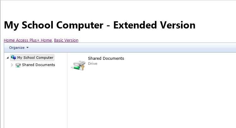

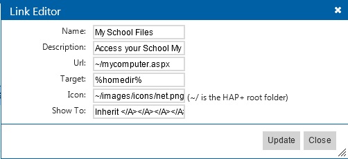

When I browse my computer within HAP i cannot view my home drive. I have changed the properties so it reads %homedir% but it doesn't show in extended or basic. I have mapped a drive using the HAP UI and that works perfectly. All other aspects of HAP are working fine. I have attached screenshots.
Thanks,
Rob
You don't add %homedrive% to the target box. The target box is to do with where the page will load, for example, if you leave it blank it will open up in the same page. If you put something in there it will open the page in a different tab or window.
The home drive mapping needs to be lower down the setup page in the same place you would set up a mapping for any other drive.
I hope this helps.
