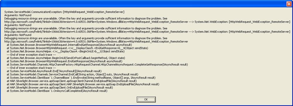

Hi Nick,
Thanks for your help with this, but still no progress I'm afraid. I've tried the {0} again, together with FQDN for the quota server. I then added FQDN to all drive specs (including mappings) but makes no difference. I always get the connection to the home drive, but no indication of disk space. The green bar is always full (it shows for a few seconds and then disappears when the My Computer view shows) and are no out-of-space messages on upload.
If I try to upload a file and the user is *already* overspace, then an exception is reported to the user in the browser (see attached).
Additionally, the error log of the server reports:

Here are my current mappings:
\\SRV01\USERHOME\%username%
\\SRV01.SLUDGY.LOCAL\USERHOME\{0}
Any fixture of FQDN on the UNC (either on the mapping or quotaserver) does not seem to enable quota operation.
Any other suggestions you might have would be greatly appreciated! Is there any other logging I can do?
Thanks again,
Moby.
try \\server-1\homes\{0} in the quota server instead, also add a FQDN UNC as well

This error I think is down to the square brackets, I don't think the HTTP standard likes them
I'll try your %username% suggestion again as soon as I can, although I'm pretty sure I've already tried all of these combos + FQDNs. The share is not hidden.
Does the quota service support both the disk-based quota system (the Win2K method) and the newer FSRM method?
The exception error is raised on any file name (e.g. "build.docx") it just so happens that the above upload had square brackets in it.
Thanks,
Moby.

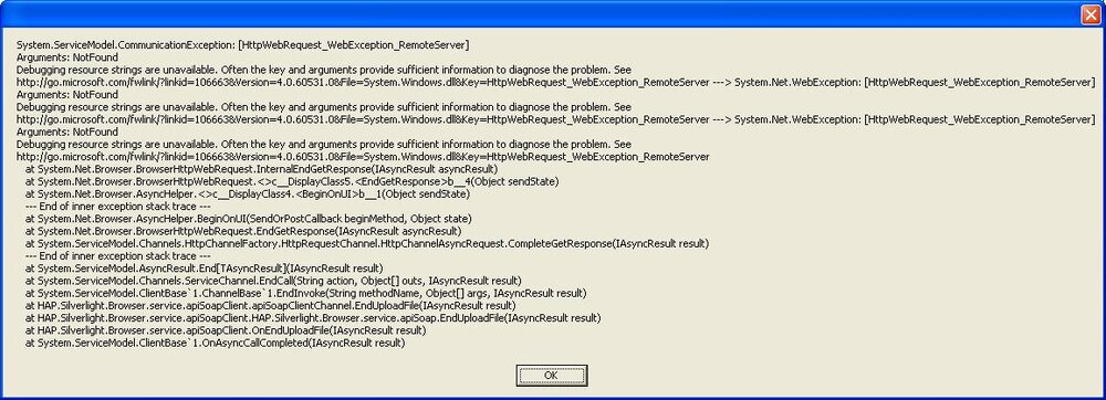

Hi Nick,
The updated "Hap Quota Service" you provided in this thread prevents the 'System.UriFormatException: Invalid URI' message that I got with the original 7.6 release on startup (and which prevents the Quota service running).
Unfortunately the newly updated version dated 28/11 re-introduces the original error. Can you include the change for the URI message in your next release please?
