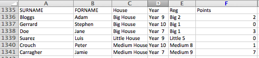

I have a large table of data like the dummy data below that i am trying to reorganise by using a formula or macro (which ever is best).
The data consists of students and registration groups etc. I want to split the data into registration groups to ultimately be able to print the data with one registration group per page. Any suggestions how i would achieve this?
Thanks in advance.
Is it possible to have some sort of formula that would carry out an operation like:
IF CELL IS DIFFERENT TO CELL ABOVE INSERT 3 ROWS
Thanks
You could create a macro which would insert a pagebreak as the value of the group changes. Assuming the data is sorted and the data you want to create the page break on is in column 3, something like :
