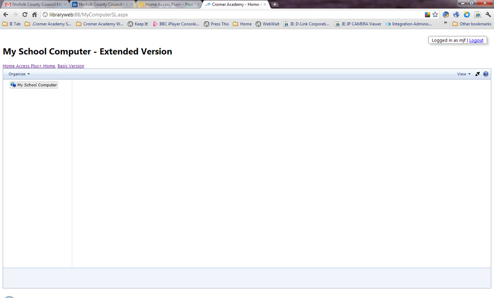

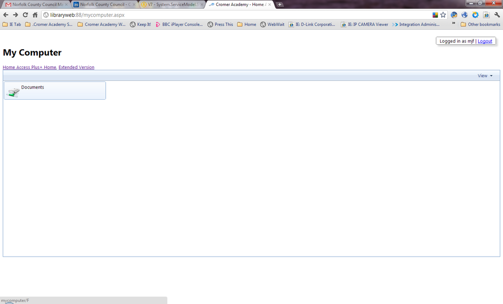

I've got HAP running with the helpdesk and booking part working ok but I just can't get the computer browser bit working. here is a screenshot of the basic and silverlight interfaces. These problems are the same in all browsers. Silverlight is just not displaying anything apart from the my computer icon. The html version does display the mapped drive but tries to open a page called "mycomputer/F" which it can't find (i took the screenshot while hovered over so you can see what it's looking for.
Have I missed something in the iis setup.
This server already has eclipse.net library software on a different website which runs flawlessly in silverlight with auto log in as well (hence HAP on port 88)

One thing I did notice was that when I first click on the my computer icon it doesn't ask what version it just plonks me straight into the basic one. Have cleared cookies and this was a new install for 7.2 anyway. Has this selection been removed? Can I force it to silverlight as default instead?
Again that doesn't sound right, I did a new install of the current build a couple of days ago and it asked me which I wanted to use. It has only asked once, though. I would have thought that preference was stored within a cookie.
Yes that is the cookie for the silverlight/html browser. Setting it to SL tells it to use the silverlight version when silverlight is available. Alternatively you can browse to /hap/mycomputersl.aspx
If you get a 404 page not found when you browse to that page, you may not of set the application pool to integrated pipeline mode, or in IIS6 not adding the wildcard ISAPI mapping
