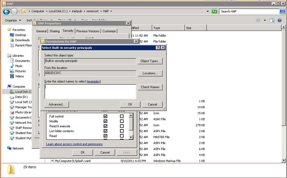

Hi Nick - I can't add the IIS AppPool\HAP to the permissions. I've selected the local machine, however note that in your video you are searching for "User, Group or Built-in security principal", whereas I just had "Built-in security principal". Any idea how to add the app pool?
That is very odd, usually just making sure you type in the correct username (IIS AppPool\HAP) and make sure it's on the local server works, no searching, as searching doesn't find it
IIS7. The step in question (21 in your PDF file) is on the folder not IIS, though, or have I misunderstood it?
@gavlar - what was the command line you typed to add it?
That's what I thought - definitely can't add that user, possibly because I can only search on "built-in security principles" when searching the local computer - is there a way to change that, or some other security permissions which I could set instead of adding the IIS AppPool?
This is what you should be looking at. You need to make sure you are remoted into the IIS Server, not trying to do it via another computer (i.e. \\chs03\wwwroot or \\chs03\c$\inetpub\wwwroot)
[ATTACH=CONFIG]11404[/ATTACH]
Just clicking OK on this will accept the username

I have tried the cacls command as described thanks and it sets permissions on the HAP folder but the HAP user is not shown anywhere lower down in the structure. I also had the original issue where I do not get the option to see user, group.. in the object type.

icacls C:\inetpub\wwwroot\Hap /grant "IIS AppPool\HAP":(RX)
Also
[ATTACH=CONFIG]11648[/ATTACH][ATTACH=CONFIG]11649[/ATTACH]
Notice I select the local server, and just type the name in, no going to Advanced...
If you are running this on a domain controller:
STOP!
1. can you run this on a member server?
a. If Yes, do so, HAP+ v7+ works best on a member server, although v6- works best on the PDC.
2. you need to enable interactive logons on the server. If your server is a Remote Desktop Server (which mine is), this is already set
3. If you insist on a PDC, make sure Buit-in security principals are selected to search in.
