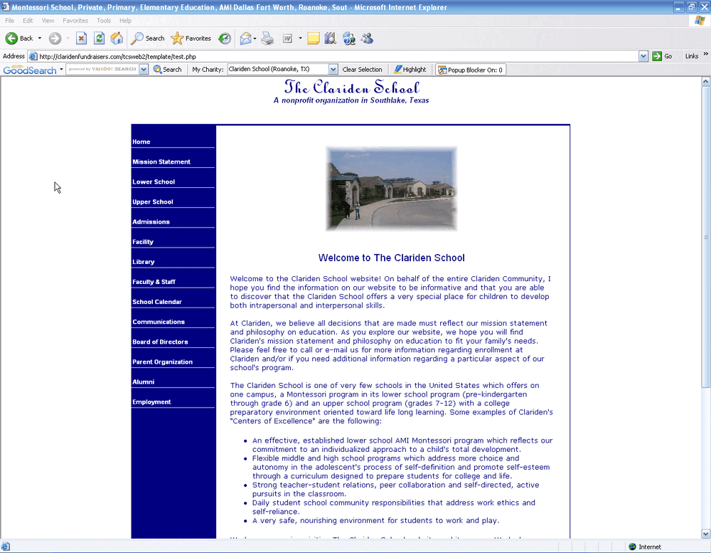

Here is an attached screenshot of what I see in IE 6.

Don't know if you know already but the menu looks fine in ie7, but when you go below li number one on a sublist, it dissapears. Makes me think you either have the width of your li or ul too wide, or you haven't set them. I'll have a look and see if I can help
This problem is due to differences in the css interpretation of IE6
You will need some IE6 only hacks in the css to solve it
