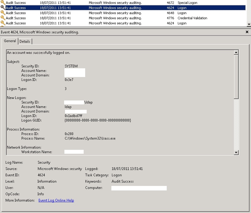

I know my ldap must be working cos i can use the ldp.exe tool and i can connect to the server and bind the User. When i try and login in to moodle i get invalid user or File not found error 404. If i check the dc's system logs it shows that the bind user i setup actually logs in. So that side must be working. Im 100% sure im pointing it to the right organisational units to find the users etc. I can only think its something to do with configuring the URL rewrite in IIS7

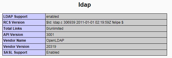

have you enabled the php_ldap dll in php.ini?
The way to check is to create a file in your moodle root dir called phpinfo.php
Paste the below into that file:
<?php
phpinfo();
then access the file via a browser, e.g moodle.school.sch.uk/moodle/phpinfo.php
Look for extension = phpLDAP or LDAP (cant remember which off the top of my head)

Just to confirm .. PHPinfo gives me this info:
here is a screen shot of the event viewer showing that the ldap user is trying to logon to the server with sucsess...
There are no local users in moodle other than the first administrator account.
