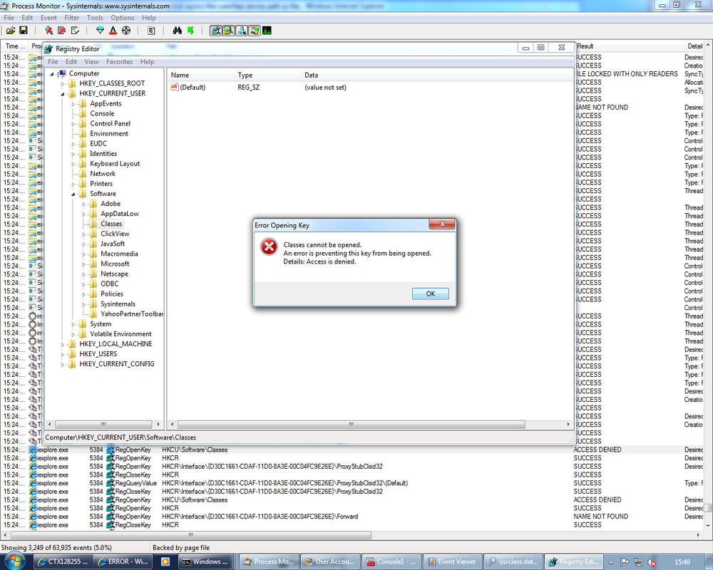

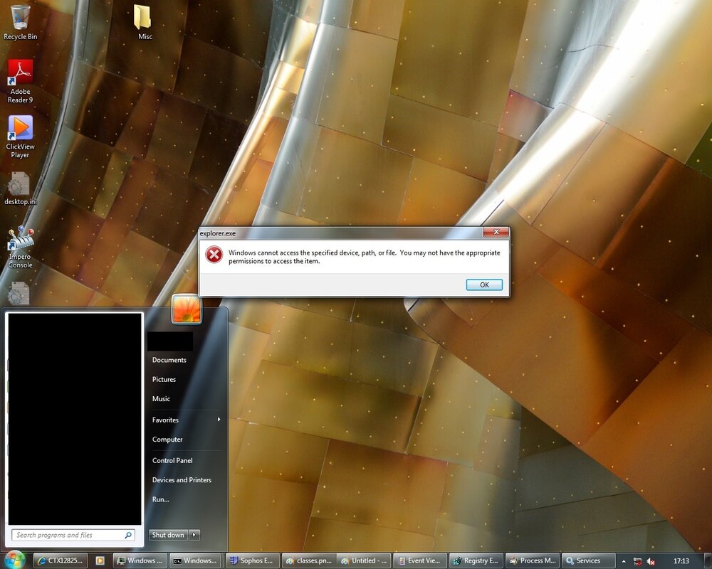

Ok, got a lot more info on this. By luck it happened when I logged onto a PC yesterday so I had full admin rights to diagnose it properly.
It turns out that it has nothing to do with networking at all. When you try to load explorer as an affected user you get "Windows cannot access the specified device, path or file. You may not have the appropriate permissions to access this item"
You can access everything fine via cmd so it's not disk permissions. If you launch explorer via an elevated CMD prompt it works fine.
You basically get all of the symptoms listed on this error here
CTX128255 - User Profile Manager Error: Windows cannot access the specified device path or file. You may not have the appropriate permissions to access this item - Citrix Knowledge Center
However, the fix on that page doesn't really help as it's targeted at Cyrix, and either way I don't have the usrclass.dat file on our "Default user.v2" profile on \\blah\netlogon - Nor would it explain why it's totally random. I can log the user on to a hundred PCs and it will only happen once, if at all.
It IS related to the users permissions to bits of the registry i.e for whatever reason affected users will not have access to "HKCU\Software\Classes" like they usually do. You can't even list the permissions via regedit.
I was able to force it to show me the permissions by launching regedit as SYSTEM using "psexec -s -i regedit" and then going to the affected users hive and all that's listed is "OWNER RIGHTS, SYSTEM, WinDefend"
On a working user, the permissions are "RESTRICTED, SYSTEM, , Administrators"
I admit I'm somewhat lost now. I can't find anyone else with the same issue other than that Cyrix blog above. I don't recall changing anything major recently, aside from rolling out SP1 just before half term. As I have no way of forcing the error to occur I can't tell if that is what is causing it. It's like something is upsetting it during profile creation.
