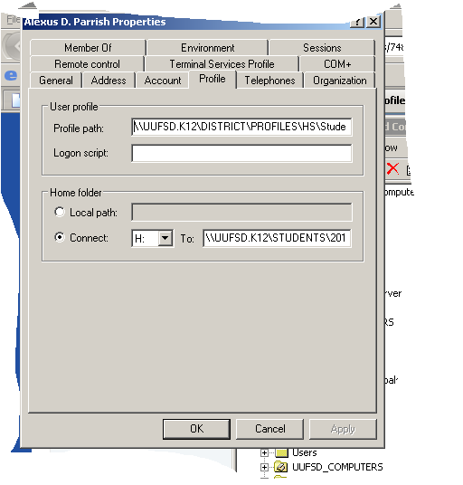

dhorowitz Posted April 29, 2011 Author Posted April 29, 2011 Attached is a picture of the profile info tab from the user's account in AD. I can successfully explore to the location of the profile. If I log in as a user with the old profile, everything works normally. According to the application log on the workstation, the user that is generating the errors is the NT Authority\System account.user.bmp
