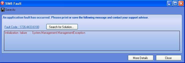

Rawns Posted November 23, 2010 Posted November 23, 2010 (edited) This problem crops up every now and again and is a strange issue that I can never seem to fully fix. It only seems to affect mainly teachers workstations/laptops rather then admin staff's PCs or servers in schools. There is no paten as to when this error will crop up, its just random. I'll install/reinstall SIMS .net onto a PC and when I launch it, I'd locate the Connect.ini file in the S:\SIMS which contains all the info regarding the Server, instance, Database name etc. Once selected, a Connect.ini file in C:\Program Files\SIMS\SIMS .net gets automatically created to redirect to the one on the S drive. If you do this though, sometimes SIMS throws out this error: If you delete the Connect.ini in C:\Program Files\SIMS\SIMS .net, launch SIMS again and this time, point it directly to the SQL server & instance, it works perfectly fine and loads. When it works, I have tried deleting the connect.ini that points directly to the server and revert back to redirecting it to the S drive but the error will reappear again. Anyone had this before, and managed to pin down what causes it? Edited November 23, 2010 by Rawns
apeo Posted November 23, 2010 Posted November 23, 2010 Use to point some of the older computers directly tothe SIMS server because of this error. It only affected a particular set of computers here so just set those ones to go directly which is fine until you change/migrate the SIMS server.
ScottLogan Posted January 31, 2012 Posted January 31, 2012 You may have another .ini file in the system32 folder that maybe causing an issue
