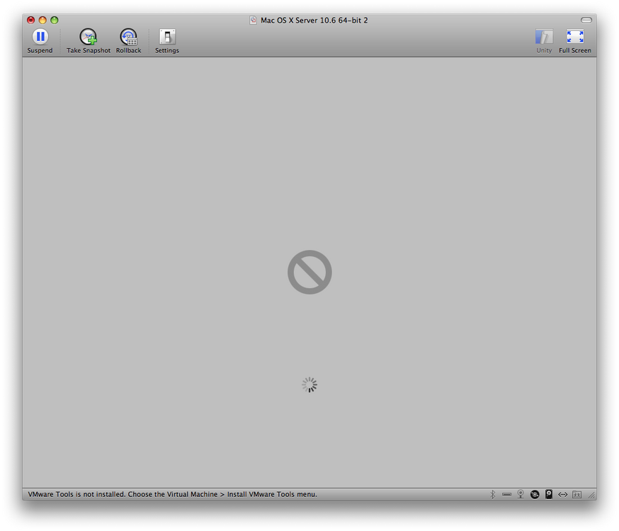

It seems to be installing from the install DVD Ok however, it doesn't seem to like to install from a disk image I created from the DVD. When booting from the disk image, instead of a grey apple image , I get a grey "No Entry" image and it never reaches the "Choose Language" screen. The disk image mounts on the Mac OK.
Odd
Thought I'd post this screenshot to clarify what I'm babbling on about!
[ATTACH=CONFIG]8630[/ATTACH]
I have had the same when using a copied disk.
When i get media i like to make a copy and use that so i dont damage the media.
There's also "hdiutil" (via Terminal), but I doubt that will work if the other methods didn't.
hdiutil create -srcdevice /dev/disk1s0 -format UDTO ~/Desktop/SnowLeopardServer.iso
