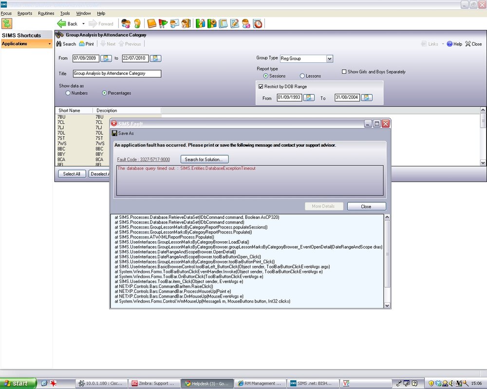

Hi All,
Just thought I would throw this into the mix:
Anyone any ideas as we have run these large reports with no problem before the last update then this!!
Cheers in advance :)
Does the report run if you select a single reg group? (i.e the report does run on a smaller set).
Does it work if you sling
CommandTimeout=100000
into your connect.ini ?
If the report takes ages to run and ties up someones machine then it may be appropriate to use the Report Scheduler in SIMS.
First look at the attached PDF and also look under SIMS Help at "reports, scheuling".
Setting_up_the_Report_Scheduler_11982.pdf
Having looked at those schedule the Appropriate report from SIMS .net under "Focus | Alerts | Schedule Reports" and target the right user.
