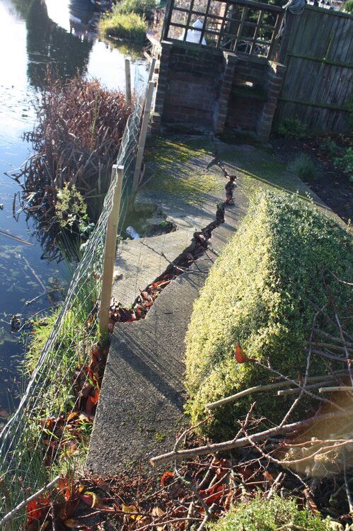

the new house we've bought, our back garden backs directly on to a canal. At the bottom of the garden we have a concreted area which is showing signs of cracking and is slowly falling into the canal. This has been caused by the flow of the water and the boats passing pushing the water against the soil underneath and eroding it.

i'll take some pics, as the bottom of our garden is a safety risk. a 3 ft chunk of concrete is now at a 45 degree angle to the canal, and cracks are showing elsewhere so you can't actually walk on that part without a risk of it sliding in.

this is the bottom of the garden as of this weekend:
Lost my thread there, Take pictures close up showing movement against a ruler from a static point. Dont allow the 'crete or that BBQ to fall into the channel though as you may end up getting counter sued from BW and Mariners if a boat is damaged. Cant see how wide the chanel is there. May be an Idea to brake up that section with a sledge hammer and remove it to prevent it falling in so long as you have documented the current extent of the damage. The only long term solution would probably involve sinking pilings into the edge and back filling with concrete, Or Oak lasts well in water do to its hi tanin content. Possibly better than steel, and you could pick up some cheap railway sleepers all creosoted. (may leach into the waterway though) Edited by Hacksawbob
