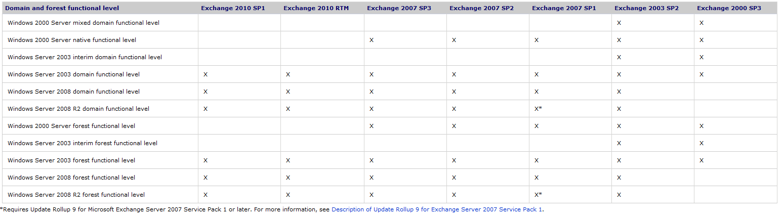

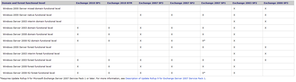

I am wanting to upgrade my domain and forest function level over the half term so that windows 7 can be supported with the new group policies etc. My only concern is that we have an exchange 2007 SP3 box running 2003 R2, all patched up etc and was wondering if i upgraded the forest and domina function level, would this have any effect on my exchange box?
Ive got a test domain but exchange needs the internet to access some of the updates to install and this test domain aint on connected to the net.
