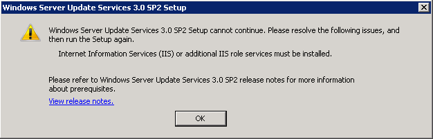

I am trying to install wsus on my 2008 box - but everytime i install it brings up the message (below).
the annoying thing is IIS is installed, but it says it isnt.
Anyone else had any luck/similar problems?

Hmmm WSUS should install all the additional roles it requires (and tell you what they are). Could you remove IIS and then try installing WSUS? I presume you are trying to install WSUS from server manager?
