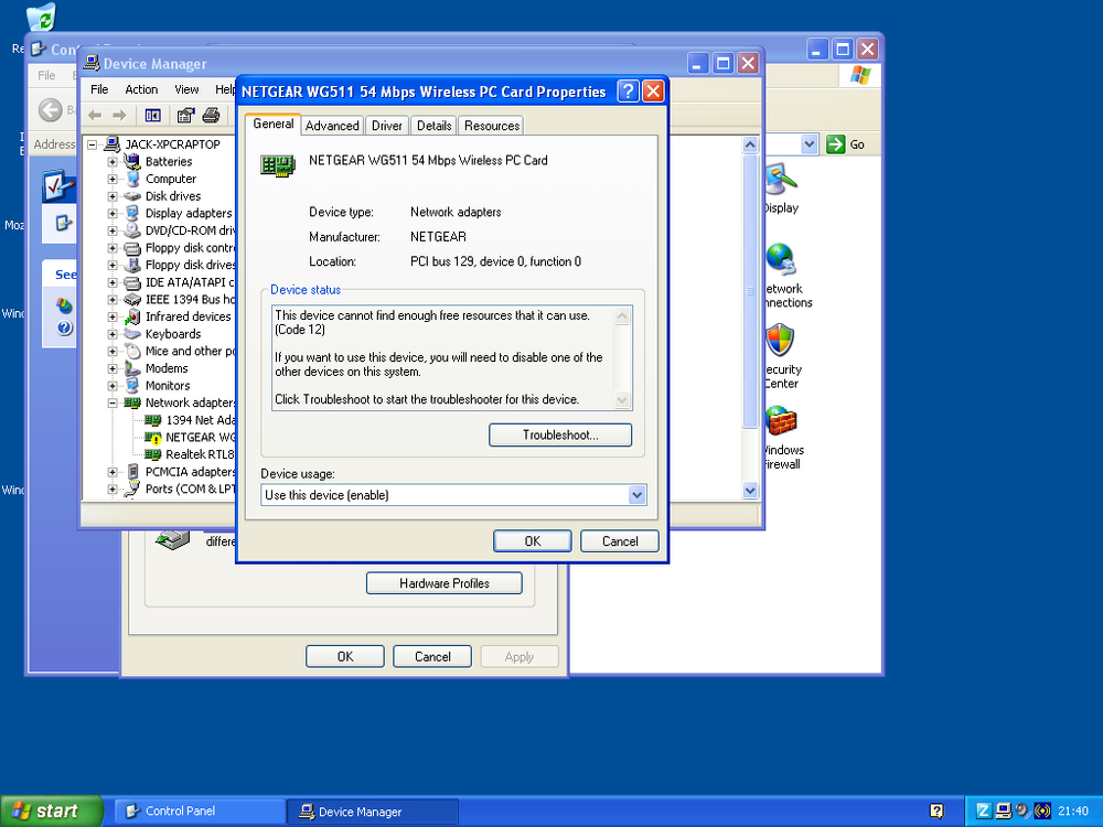

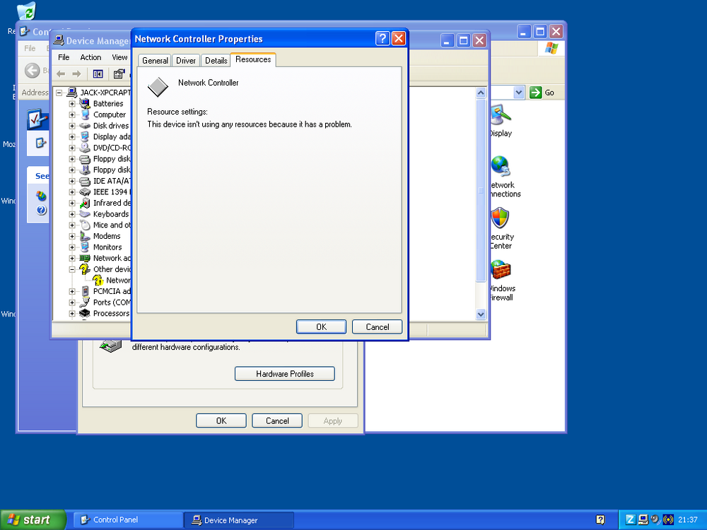

Jackd Posted September 25, 2010 Posted September 25, 2010 I've got a Netgear WG511v1 PCMCIA network card for a laptop. I've got two of the same laptops that both have the same image on them. On one laptop it works fine but on the second it either just displays the card as a generic network controller or it displays it correctly but says "The device cannot find enough free resources to use". I've attached some screen shots showing the error. The card itself works fine on the same type of laptop with the same image so I'm guessing the slot is broken on this laptop? Thanks

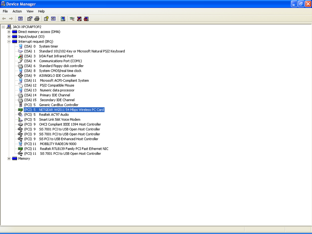

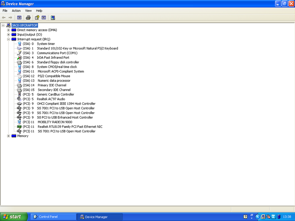

Jackd Posted September 26, 2010 Author Posted September 26, 2010 Ive attached two screen shots from the resources view of device manager. I think it may be the slot though, when plugging the card into that laptop its just detected as a network controller but if i wriggle it around a bit it'll then get detected as a WG511. Sounds like it's the slot right?
SYNACK Posted September 26, 2010 Posted September 26, 2010 Could be the slot but it is an odd presentation, it looks to be trying to share IRQ5 which already has two other devices on it one of which is a realtime audio device which could be causing problems. One way to check if it is the hardware could be to swap the HD from the identical working on in and see if it finds the card fine, if so its the OS, if not its hardware.
