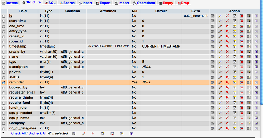

Can you add custom fields to the MRBS booking form part where you book the rooms? I've created the fields in MYSQL but didnt know whether i need to do anything special to make them appear in the booking form part?

The fields i've added to the entry table are in the attachment.

you'll have to add a to the row of GET statements at the top to extract the field from the form itself once it's been entered by the user once.
you'll need to add the field names into any SQL select statements that you see where it looks like it's pulling in info about the booking e.g. room name / id. i looked it's a bit confusing.
lastly (hopefully), you'll have to add to the html form itself space for the field.
probably clone a free text box if there is one. give it a unique id/lable, and in the value use a php code similar to below. the echo command will insert the data referenced into the html. you would reference the $name that you added for the variable earlier on.
