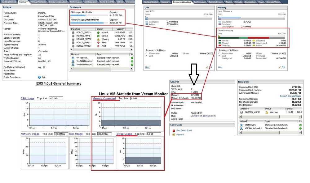

I’ve got a strange problem, How come my ESXi got so large swap
file size ~ approx. 3.5 GB while the amount of total RAM is still not
100 % used.
I've assigned the following specs as in the screenshot (4 vCPU for better performance).
Can anyone explains why this VM still using swap file?
FYI: The VMware tools is not installed in this VM.
When I look at the Guest memory % usage it doesn't make sense to me that this host running slow due to the Swap file created (ESXi swap as well as the Internal VM swap file).
The VM that i highlighted is the slowest with big swap file created. --> See the screenshot attached.

I would recommeded the following.
Install VMtools to enable the balloon memory driver (screen grabs says not installed)
Add a memory reservation for the VM, try 50% to start with.
Another note, espiacllay as you have 4 vCPU's VM's, enable hyper-threading if available.

Hi Andy,
thanks for the reply.
Does this means that by not having VMware tools installed the memory over allocation is killing the host by writing into the ESXi swap file ?
Hi Andy,
VMware tools provides a memory balloon driver, which can be called to force the VM to page internally when ESX host is short of memory (use VM's own internal swap/page mechanism).
ESX only writes to swap file as last resort. Make sure your machine does need 4vCPU's and 8Gb memory, reduce now and add later when/if needed.
