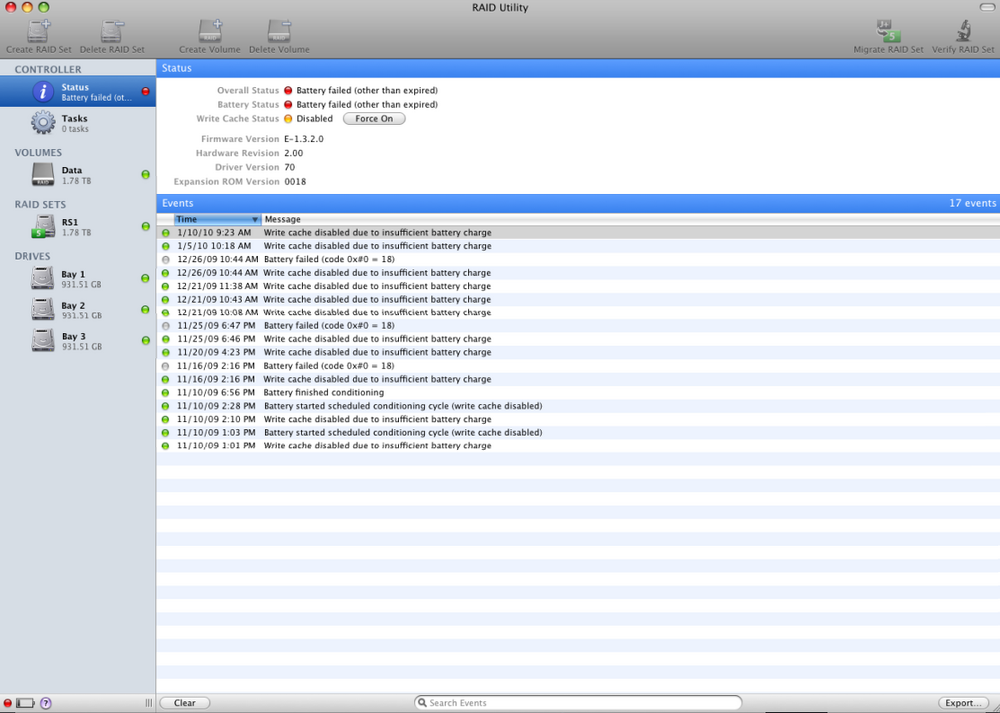

Only had out new xserve a few months, but already, every time its booted up, I get a prompt saying 'RAID utility requires your attention' where I receive the message that the battery has failed and write cache is disabled. Sometimes it will be charging at this point, at other times it will just be red and disabled.
I read somewhere on the net that disconnecting and reconnecting the battery has helped some people, which I did just before christmas and amazingly seemed to have worked for a few days.
But back in today and its not working again
I assume its not a critical problem, more just degradation of performance, however I would like it get it sorted. Is is a spare Apple would send out under warranty or charged as a comsumable? And assuming I do have to buy one, do they sell them?

Thanks for the reply
When first installed, the xserve would have been on for 72 hours easily (after initial setup and updates were done anyway)
When the battery hasnt been reported as failed, I have turned write cache on but of course this is off again when it has failed.
Didnt really make it clear what I meant - the server is on 24/7, but the battery is continually 'failed'. Before Christmas I was doing updates and sorting out some things on it, which required reboots, hence why I say the utility comes up every time with the message. I also have occasionally restarted it in the past as this would get the battery to report as charging, as it just will not do this once it is reported as failed.
All updates have been done, cant remember any firmware ones specifically but I will check.
It also definately isnt the 3 month conditioning.
From what you've said then I think it probably is a problem with the battery so I will contact Apple I guess! Thanks
Edit: Ive attached a screenshot
Edited by sidewinder
Hi Sidewinder
You're welcome. Judging from what you're saying in addition to a definitive screen grab it looks like there is a problem with it. That error message I've not seen before . . . yet.
A call to AppleCare or the Reseller (if used) would be the next thing to do. Judging by the MacPro Apple RAID Card the Battery itself is not that difficult to replace. It's about the size of an After Eight Mint and about as thin. Having never replaced one in an XServe it's not certain if it's the same?
You can run the Server whilst it's like this but don't leave it long. If there's a drive failure there is a potential for data loss on top of increasingly poor performance.
