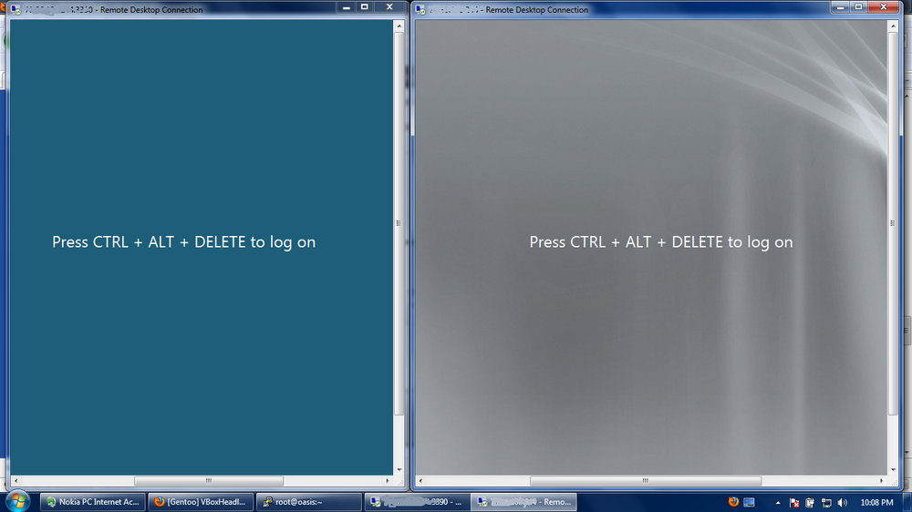

Might be worth me posting up a warning somewhere here not to upgrade to 3.1.0 blindly like I did without reading the changelog as this has changed dramatically.. and Im sure is also the reason my other VMs keep dropping out.
OK well that was causing the VM to bluescreen at boot
So Im thinking that as it was a IDE drive before and now I made it a sata, Ill try setting it back to IDE
VBoxManage storagectl "2008Server" --name 2008server --remove
to remove the sata drive
to remove it and then
VBoxManage storagectl "2008Server" --name 2008server --add ide
to create an IDE controller..
and then the same previous command to attach the existing .vdi to the new controller:
VBoxManage storageattach "2008Server" --storagectl 2008server --port 0 --device 0 --type hdd --medium /root/.VirtualBox/VDI/2008Server.vdi
And now it boots fine...
Hope these ramblings might help someone else...
