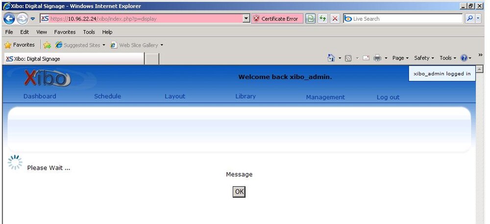

Hi Guys,
I'm having a bit of a problem getting a Xibo Client to talk to the Server. The client says it's waiting for a license from an admin. I've logged on to the servers web page using https and looked under 'Management', 'Displays' and all I get is a spinning wheel with 'Please Wait'. The display I want to authorise does not appear here.

1 display, no imaging. Complete fresh install. This is on a test bed. So Server 2003 VM running XAMPP and Xibo 1.04 server. Then a XP SP3 client VM. Client says "waiting for server to authorise". Server just sits with 'spinning wheel' and never lists the clients to be authorised.
when you say server sits with spinning wheel can you do a screen shot.
sound to me like there server isn’t listening... however if you can get access to the web admin panel it should be working...

Don't appear to. Just tried adding a user and it dumped me back at the servers home screen. Is this a Server03 issue? Should I try using XP as the server os?

Just tried changing to http:// and same issue. I'm going to give both VM's a reboot and try again with http://
