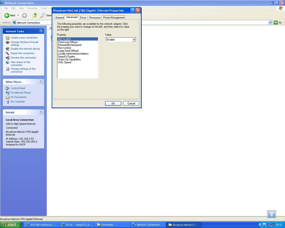

Attached a jpeg of where you need to get to
Goto Properties of the NIC, click Configure, and then the Advanced tab.
On the older Stone machines, they had some settings relating to the WOL, the attachement is my Lenovo machine.
Hope this helps.
