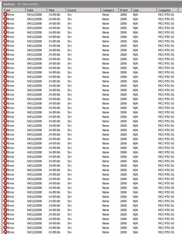

Right the event viewer is showing over 200 identical errors every second! (screenshots attached).
I did have the mains trip in the server this morning due to bad weather but i switched it straight back on again as i was in there when it happened! The server didnt turn off as the ups kicked in ok.
I suggest a re-boot - specially after the mains trip like you stated - when its backup monitor the event viewer again.....and make a note of any other services that fail - [ a pop up will appear on the screen after it's booted if a service has failed ]
