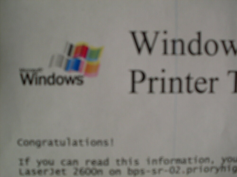

Quick picture of a test page I took (not best quality I know). I genuinelly have tried all the calibration and reseating to no avail, which I would have thought would certainly fix this.
dhicks, you're right in that is costs £160 for a full set of OEM carts, and £120 for a full set of reman carts, and the reman carts price cost us just a few £££ less than the printer did when we first bought it (albeit with "starter" carts).
It would be extremely difficult to justify printer replacement after just over a year...
Black prints fine - near perfect in fact (what I would expect) - it's just the colours, so i'd have thought paper or feeder would affect transfer of any toner? Although the picture is blurry, that is because I was doing it quickly - the actual print quality is fine - just the alignment of the windows logo with the colours.
