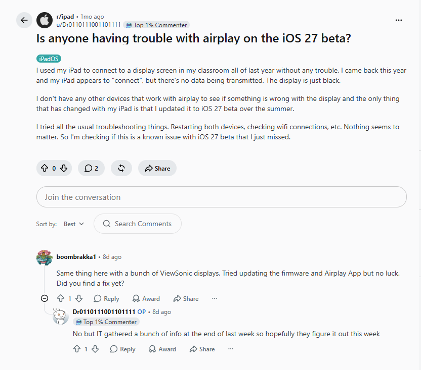

Sheridan Posted October 6 Posted October 6 Some of our Staff iPads have upgraded to iPAdOS 27 and we've noticed that Airplay to Viewsonic screen now no longer works - they just get a blank screen after entering the pairing code. The same iPads on 26.6 still work fine Anyone else had any issues like this? The viewsonic boards won't get any firmware updates as they're a few years old so if Apple don't fix it we're a bit stuck

Sheridan Posted October 6 Author Posted October 6 15 minutes ago, 6Foot3 said: Just looking at what they've changed in Ipad os 27 are you using PINs or anything like that for AirPlay? Maybe try turning off pins and see if that works. Yeah the Viewsonics display a pin, which the Ipad still asks for - we just now see a black screen after entering the pin
BlueScreenOfHappiness Posted October 6 Posted October 6 25 minutes ago, Sheridan said: Yeah the Viewsonics display a pin, which the Ipad still asks for - we just now see a black screen after entering the pin Yes, so in the iPadOS 27 patch notes it says they've changed something with how pins work, so I'm thinking on the ViewSonic AirPlay settings, could you try turning off the pin as a test to see if it now works.
DGardiner Posted October 6 Posted October 6 29 minutes ago, Sheridan said: Yeah the Viewsonics display a pin, which the Ipad still asks for - we just now see a black screen after entering the pin Were haaving this with viewsonic and promethian that i know of, i think its all the 3rd party ones
1an Posted October 6 Posted October 6 We had this issue with BenQ boards with the InstaShare 2 app which is used for iPad mirroring. BenQ released an update to InstaShare 2 which resolved 1
DGardiner Posted October 6 Posted October 6 27 minutes ago, 1an said: We had this issue with BenQ boards with the InstaShare 2 app which is used for iPad mirroring. BenQ released an update to InstaShare 2 which resolved hopefully promethian follow soon... the viewsonics are a slassic drop and forget job so not much hope of that happening

Sheridan Posted October 7 Author Posted October 7 We're a bit knackered, the only boards we have that did work were Viewsonics, and now that's broken!
Mr.Ben Posted October 7 Posted October 7 I'm seeing issues with Air print as well - even on relatively new devices that still have updates. It's working fine on iOS 26, but broken on 27.
