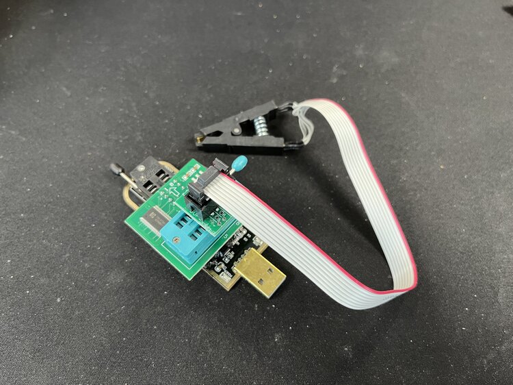

What you want is one of these:
It's a CH341A Programmer and you just hook it up to your computer, connector the other end over the CMOS chip where the BIOS is stored, save it to a ROM file and then flash/write it to your computer with the issue!  You can even download the ROM from the manufacturers website and flash that directly to the chip on the motherboard.

I sh** you not, I have one winging it's way to me from China as I type this ;)
Not for work specifically but it's being delivered here (hopefully) so you never know!
  • Like 1

I have one at home and at work, there is a hardware bug on them though so be sure to check it out before plugging it in to your PC, I had to modify mine by desoldering a pin and then soldering in a wire to the correct voltage if I remember correctly, something about 3V and 5V getting mixed up I think..
  • Like 1
2 minutes ago, synaesthesia said:
Ooh cheers, will do; I know the stuff from AliExpress tends to come sans-documentation (or as good as) so good to know!
This is the video I used to modify mine:
Oooh think I remember that one. Adamant and Sorin from electronicsrepairschool make up much of my Sunday viewing when I'm fishing (and clearly not catching!)
