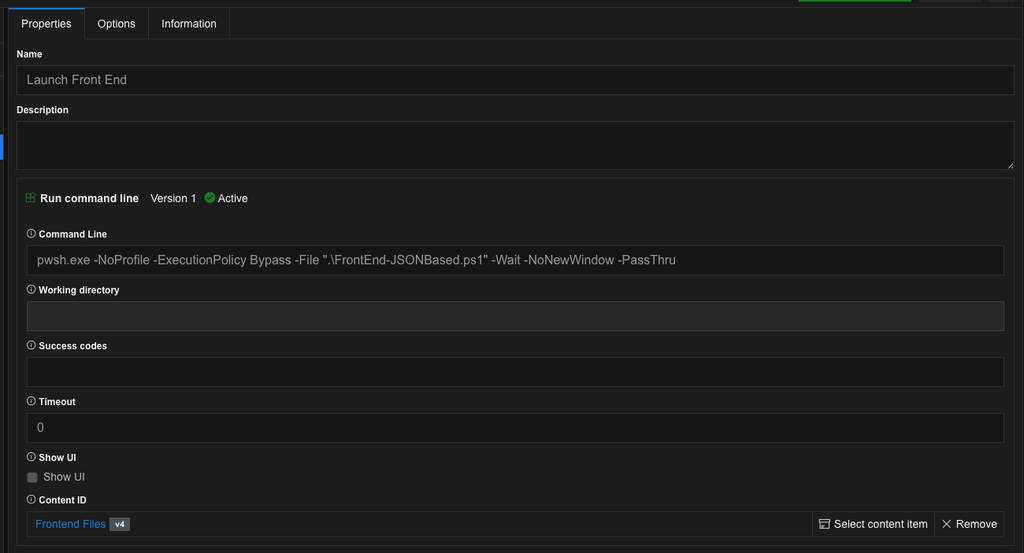

We're running the paid for Enterprise version of DeployR, (have been since December 2025) however I'm running the frontend script as a standard command line script not as a "Run Server side script" which I believe is Enterprise only.
In reference to imaging a PC already in AD, it's my understanding that anything imaged with something other than DeployR will have to be manually deleted from AD, but once DeployR has imaged it once, it can be imaged again without being deleted from AD. https://documentation.2pintsoftware.com/deployr/reference/step-definitions/offline-domain-join
I've just spent the last few hours making some changes to this and trying to streamline it...
Our TS step to launch the above is
Hopefully that might help.....
