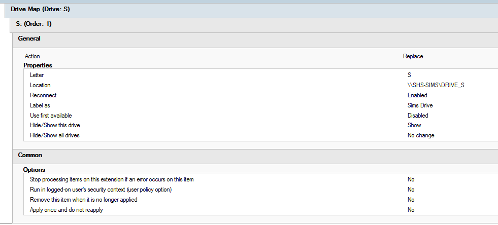

Weird one here. We have just replaced our Sims server and its got a new name.  (We map the S drive to Sims server)
We have updated group policy for it to update/replace and its not applying automatically. (Both DC's are fine and replicating without any issues) - Even created a new policy with just that drive map and its still not working.
When we force a client pc to update it will apply the network drive but wont apply when they log on.
Is there something missing somewhere?

Maybe related to the Action? Create/Update/Replace/Delete?  Try Update or Replace? Been ages since I double checked what those action labels actually really really do though, so test carefully
Are you using GPP in your user GPO for the drive mapping (as iirc 'update' and 'replace' are two different settings and do slightly different things)?
I remember having some difficulty doing something similar with printer mappings when I changed our print server. From what I read I should just have been able to choose update or replace (can't remember which now), but for some reason it never seemed to work, or I got 2 (the old AND the new). In the end I put a delete (apply once) to apply first (higher order) and then a create. YMMV but this way you could see on a test machine in a separate policy test OU, if once the old S: drive has been deleted the new one applies.
I've also had it where a setting was being overridden by a setting in another policy, so best if your test OU is completely clean.
Strange that it seems to work if you force the gpupdate, so maybe for some reason the drive maps are taking a little longer than the log on (network issues/slow NIC on startup, other GPOs applying - do you have a wait for network GPO applied)? What about multiple log on/off attempts on an already booted machine, does it kick in then?

Ok - Mini update, New users logging on to the computer S drive will map fine.
Users that have already been logged on to - Wont map. Until gpupdate /force is ran, and its fine until the next time the users logged in.
I have added a delete "S drive" in the drive mappings in first and map S drive in second.
I am tempted to change the connect.ini to point to UNC until i wipe computers.
