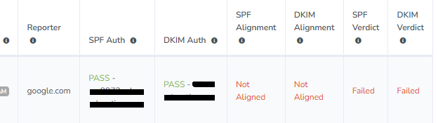

I've checked the matched rule which says 'Spoofing and Authentication (Domain Spoof or No Auth'), but analysing the headers in MX toolbox show all passes for TLS, SPF, DKIM etc.

Although, the MX toolbox header analyser seems to pass it also has this line - "X-Gm-Auto-Quarantined 1" and I've found an email that failed in my DMARC report as the emails appear to come from the platform they have some sort of extra information in the address such as "<header_from>schoolname.co.uk</header_from> </identifiers> <auth_results> <dkim> <domain>example.com</domain>'' and 'bounces'.
Which might explain the 'spoofing' part...?

IIRC an email can pass DKIM, in that it is signed, but not pass the DKIM alignment portion of DMARC (if the domain in the DKIM signature doesn't match the envelope's 'from' domain). That would be a misconfiguration on the part of the sender: at that point your Gmail service is just honouring the sender's DMARC policy, which might be instructing Gmail to quarantine it regardless of whatever rules you've got set up.

Also you are correct it fails on the DKIM alignment (that's annoying):
