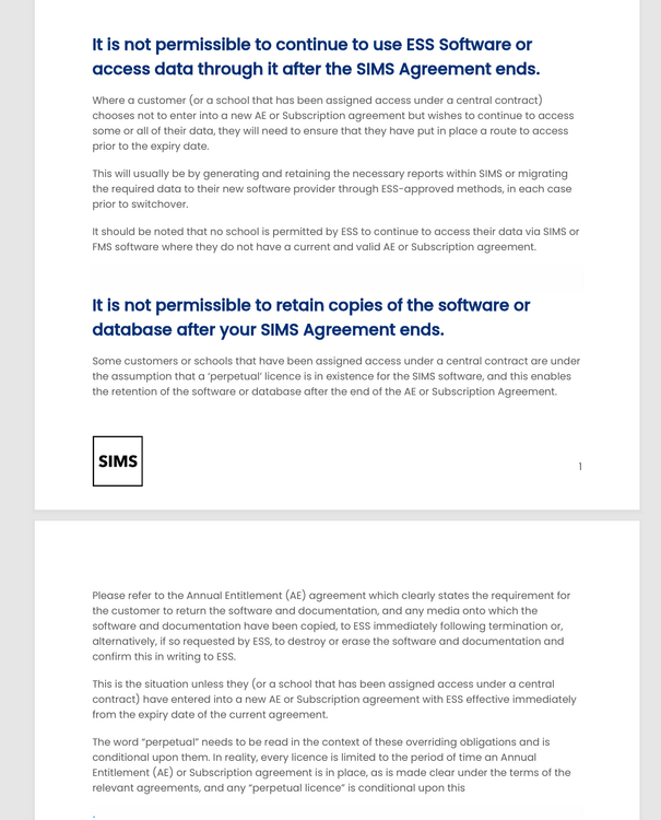

It's probalby against the T&C's of cancelling your contract mind.....
Unfortunately so - Customer obligations on expiry of an ESS software agreement V0.2 29 January 2024:

But as others have said, under the ESS T&C's you have to delete all instances, databases and backups on expiry of you final licence. To remain compliant and legal we'll be doing that on March 31st and it's finally goodbye to SIMS and the ESS/Parentpay group in general. After 12 Years of SIMS, do I miss it - Nope!
