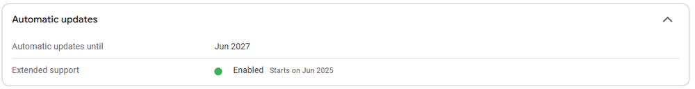

Just an update on this one, as I happen to have just looked at the console for one of my Chromebooks that is on the extended support deal.
The Admin Console looks to have been updated to clarify the extended support status of devices. My devices which end mainstream support May/June this year, are now showing as "Extended Support - Enabled - Starts June 2025"
Tiny screenshot below:

In our experience, I think you just have to leave it a while. I've just been to check on ours, which were expiring May/June 2025, and they're now showing as Extended Support - Enabled with a start date of June 2025. It took quite a while for this to show up, so I don't think it's something you can push through.
AFAIK, as long as they're eligible and you've set that setting (and you aren't locked to a specific OS version anywhere) you can just walk away and let Admin Console and device work it out for themselves. Maybe give it a week and see what the console looks like then.
