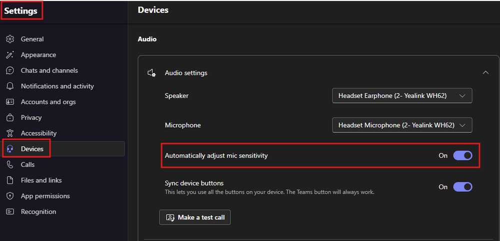

I've disabled Automatically adjust mic sensitivity in Teams and ensured Microphone is set to Headset Microphone (Yealink WH62)

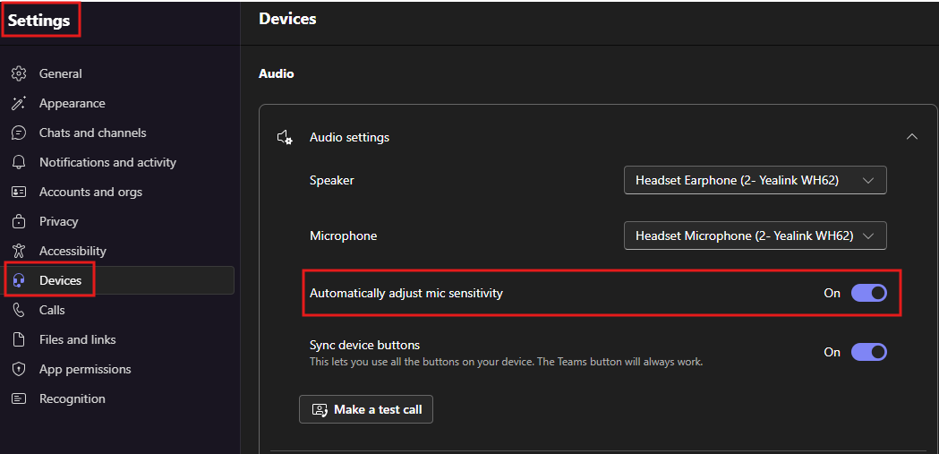

I was having this exact same issue with my WH62 on Windows 11. I found several items across the Interverse but nothing seemed to fix it. I wanted to come out here and provide what fixed it for me in case anyone else comes across this post and is pulling their hair out.
My problem was related to the Microsoft Teams Setting under devices to automatically adjust mic sensitivity. I basically just had to turn that value off and that allowed me to adjust the Microphone Input Volume slider.
Once I did that step, I was able to turn that setting back on and it continued to work as expected. Now I don't recall if that was the exact steps. There may have been some form of turn that setting off, then plug in the headset, adjust the slider, then turn it back on but I know turning that setting off adjusting the slider allowed my microphone to start working again.

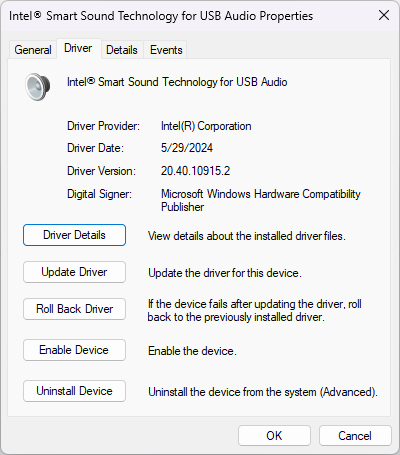

Well, a small update. I logged in this morning and had the same issue. So, it seems as though you need to disable the 'Intel Smart Sound Technology for USB Audio' device as well in Device Manager. I had done that yesterday by itself and it did not fix the issue, so I assumed that was not the problem and I turned the device back on after getting the Mic working with the steps above. I'll keep using it the next couple of days with this disabled and see how it goes.

I ran into the same problem on a 24H2 machine and disabling Intel Smart Sound Technology for USB Audio in Device Manager fixed it. No issues since and the mic works normally.
