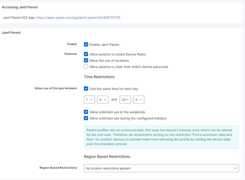

I have enabled Jamf Parent in the Organisation settings, ticked the usual self explanatory boxes and setup the time for all day at present just for me to test with.

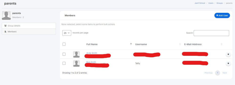

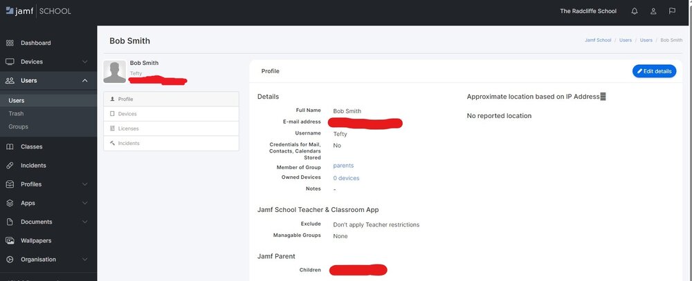

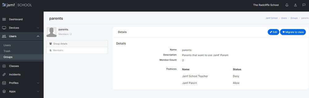

I have then created a user group called "parents" and further created a test parent user and assigned it to this group and attached a test child I have setup to the parent. The group "parents" also has the Allow Jamf Parent status set.

Screenshots attached of config for reference.

Yup I am Jamf School and I have followed that guide linked by Brimstone.
