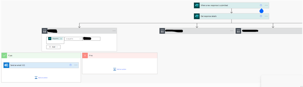

@andy_b
Could you explain the "I examine the answer to one of the questions and then direct automate to use different email responses." bit to me please? Sounds like it might be what I want because I could examine the answer from the first question and then create two different responses with only the questions I need answers to from the branching.
Thanks
Pretty basic, but below:
Each branch has a different email body depending on the results of "Department" and gets sent to appropriate HOD.
They could be a fancier way of doing it, but works for me.
