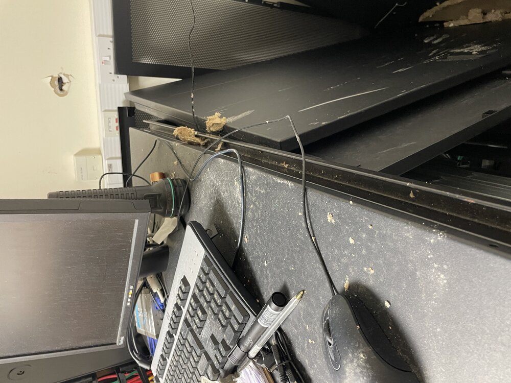

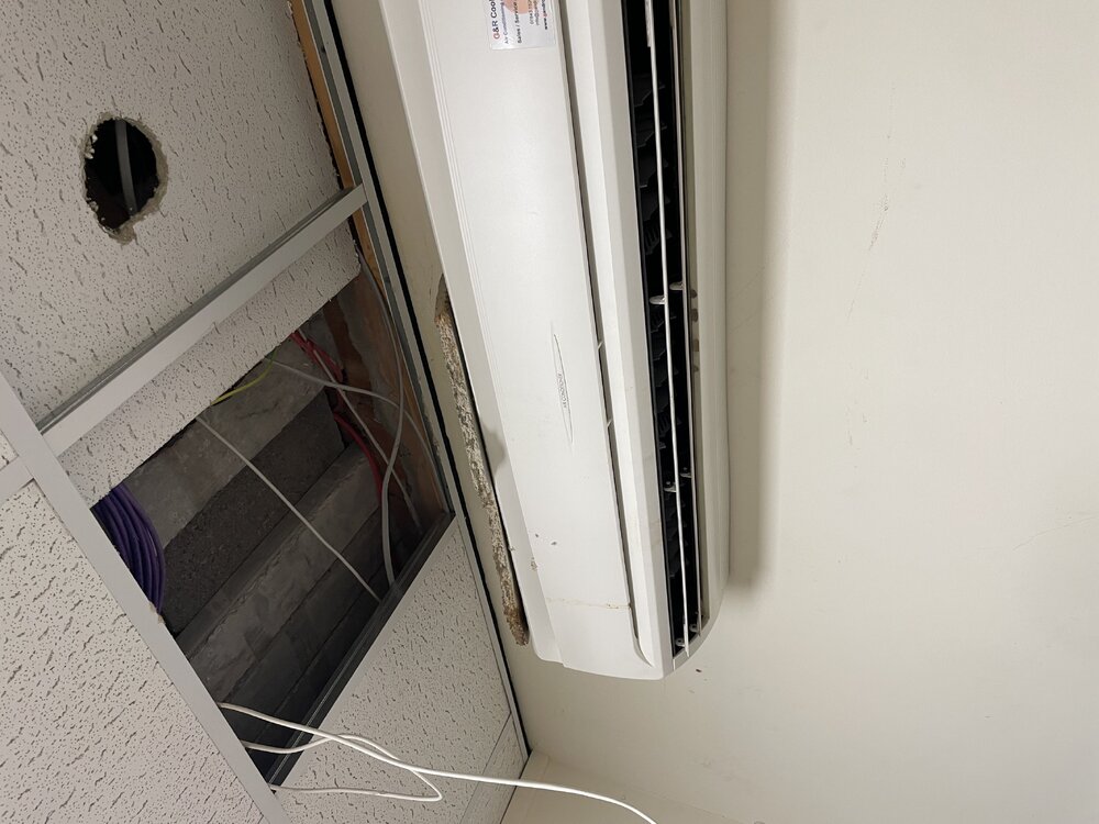

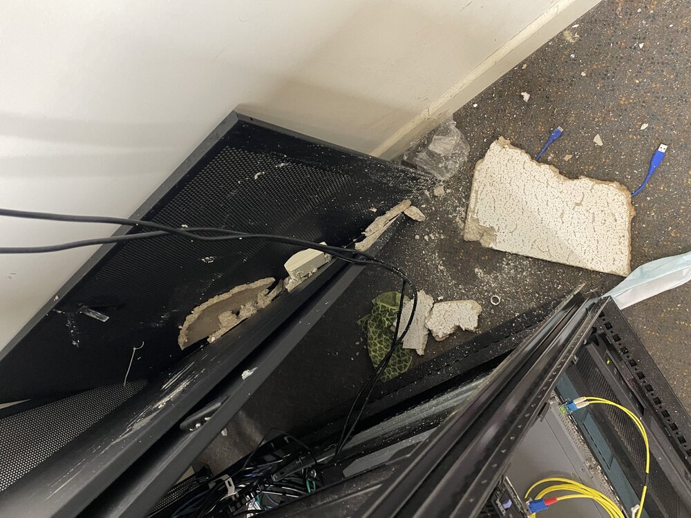

There's currently two in the server room and they've installed 3 more around the building. Do you think it'd be worth asking in the meeting this question to find out whether a proper survey was carried out? With the state they left the server room in, I have high doubts they're very good. Walked in on Thursday to find one of the ceiling tiles had been smashed to pieces and was just left, this is how I found out about the new air con install.
I told the site manager straight away as my concern was that there's a leak somewhere above which may have damaged the tiles making them snap under the water ingress and their own weight but he seems to think everything is fine and looked at it to say it could have been done by the air con engineers but even if they've left it in that state it's pretty poor. I'm going to have to tidy it all up when I'm next in and find out where there's cleaning stuff as no one else seems to be bothered to do it. I'm also a bit worried about the dust that's in the air from the tiles breaking.

Wow!!!
That's some great workmanship there..
I mean if all of the other units are indeed plumbed into the same place, the additional load could cause temperatures to rise in the server room..
Wow!!!
I know, bit of a mess. I'd expect them to at least clear up after them if they broke it.. if they didn't there's a leak and that's more concerning. All of which I've raised now to my LM.
