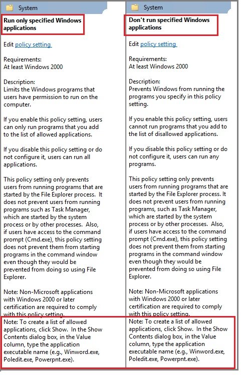

An easy workaround to not having Edge installed is - User Config > Policies > Admin Templates > System - Don't run specified Windows applications - Enabled, enter - iexplore.exe
Is the policy setting explanation for this ~GPO incorrect...?
Note: Non-Microsoft applications with Windows 2000 or later certification are required to comply with this policy setting.
Note: To create a list of allowed applications, click Show. In the Show Contents dialog box, in the Value column, type the application executable name (e.g., Winword.exe, Poledit.exe, Powerpnt.exe).
EDIT: Does this also mess with Hyperlinks...?
Edited by Koldov
This GPO is the other way round - a list of allowed .exe's. Run Only specified Windows applications vs Don't run specified Windows applications (I use this one).
So long as you have Chrome installed and followed all my other steps, it should work fine. By all means test before deploying to the masses as always!
You had me worried that I'd used the wrong one for a minute there... but it appears they both have the same 'note' at the bottom of the explanation.
Probably just a copy/paste error by someone at MS...
