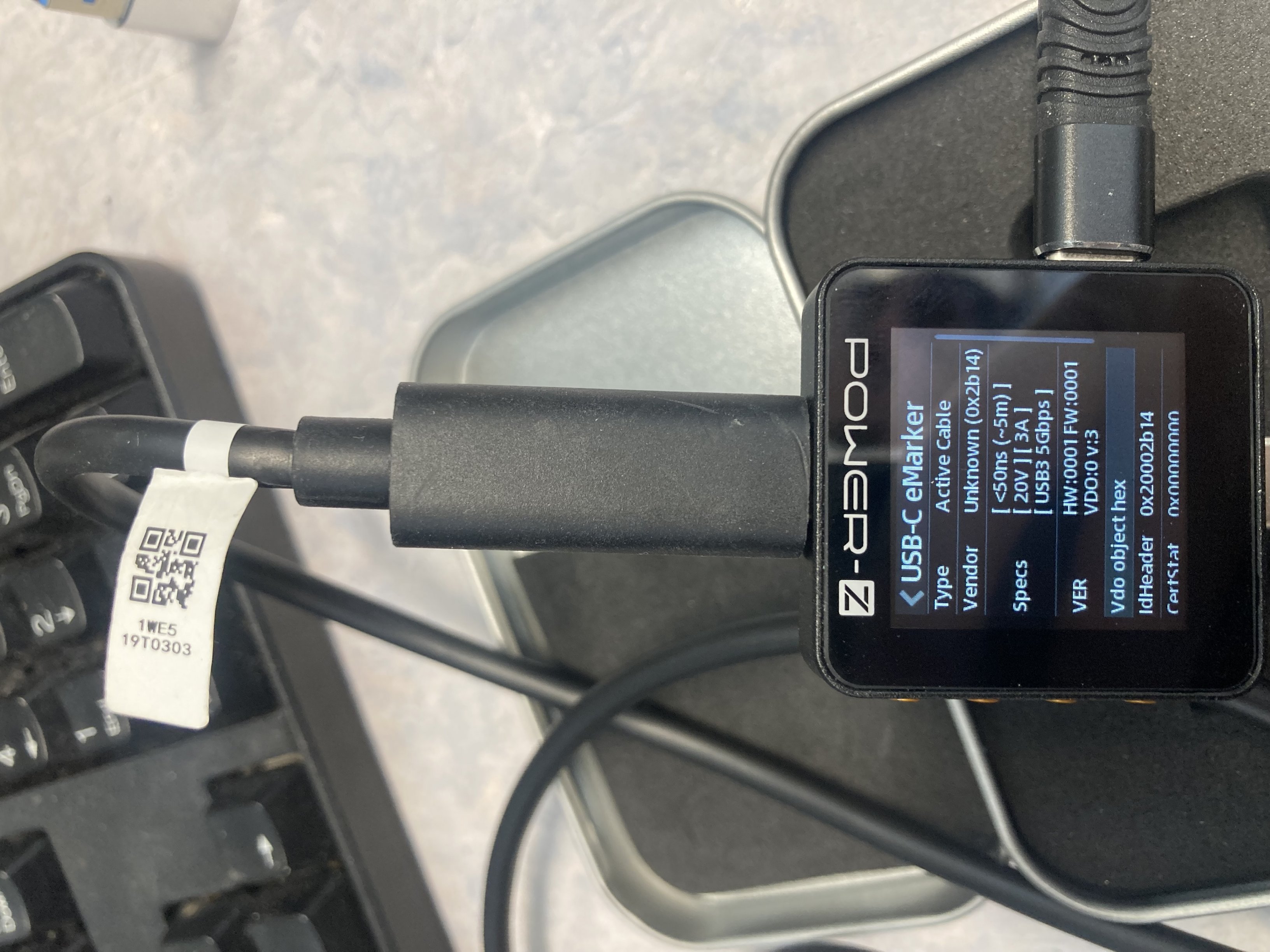

chazzy2501 Posted June 23, 2022 Author Posted June 23, 2022 just for curiosity I tried an oculus quest 5m optical USBC to USBC cable.... it did not work. it would seem that DP Alt mode doesn't work with optical USBC unless specifically designed to do so, in which case they don't do charging or data....
