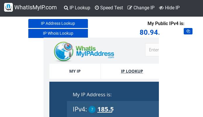

Well I've spent a good chunk of this morning digging through our Audit Logs between 9am and 3pm from yesterday to see if there were VPNs causing this. We have one or two issues with staff, but I think I've found the issue.
It seems that SBB is at any particular time of the day assigning one of three IP addresses our way. So what's happening is we have people using Google and flipping between these three IP addresses, which is clearly making Google suspicious and triggering it.
I can go to http://www.whatismyipaddress.com and http://www.whatismyip.com at the same time and both will give me a different IP address.

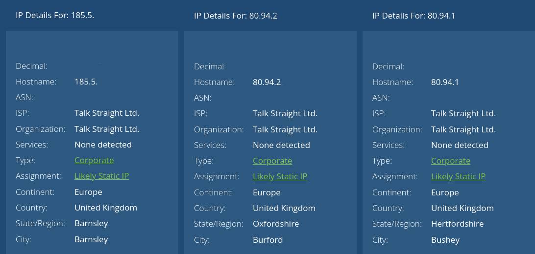

That will cause very similar problems, if you have multiple addresses going out and a device is going over that constantly, it will ring alarm bells somewhere.
I don't know the infrastructure there, but if the option to NAT all your school based traffic to 1 non changing address is possible that would stop the flipping between IPs, load balancing/multiple routes out? However, could be a number of things depending on routing, firewalling or filtering. Depending on the Netsweeper set up, you'll could see various NAT IPs depending if you aren't in explicit modes or full source IP maintaining transparent modes, but likely something for SB to look at rather than poking my nose in too far :)
