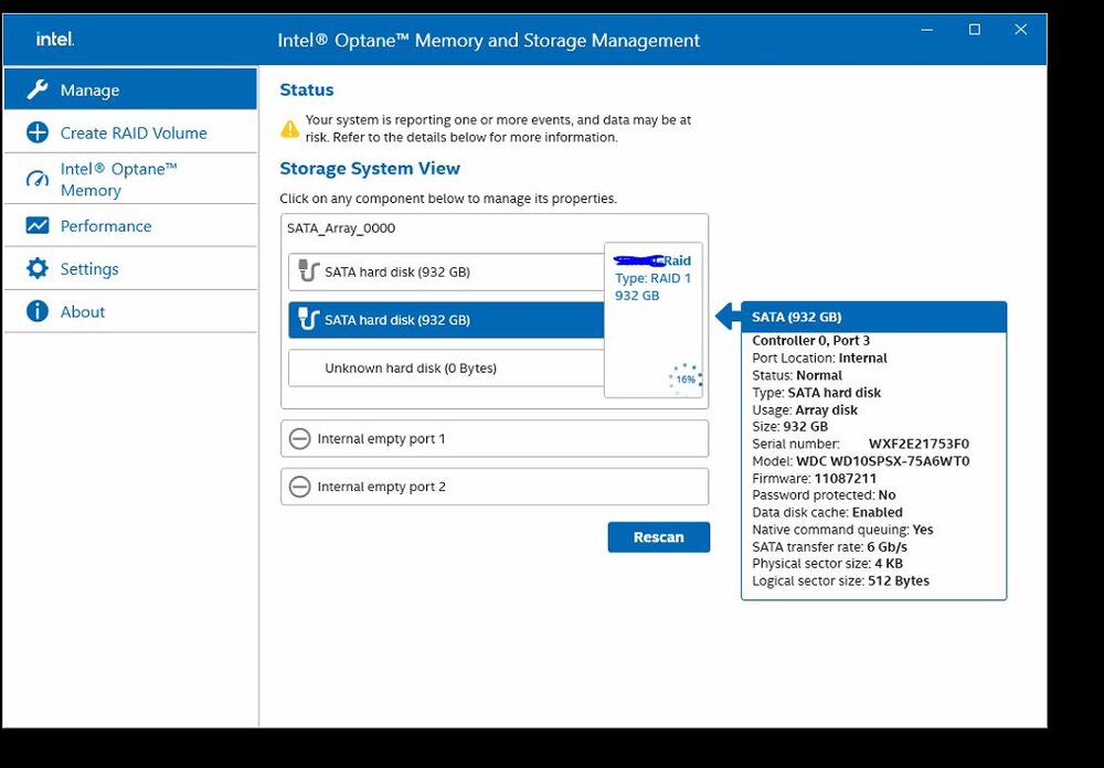

Thanks! Actually found a workaround just incase anyone else has this issueThere was a utility on the dell website called Intel Optane Memory and Storage Management Under the manage section it detected the current RAID which was already setup and only showed it one disk being in the array, there was an option to select the newly installed disk and to rebuild the array, clicked on and it looks like its rebuilding now!So seems like have to manually rebuild the ARRAY on optiplex machines
