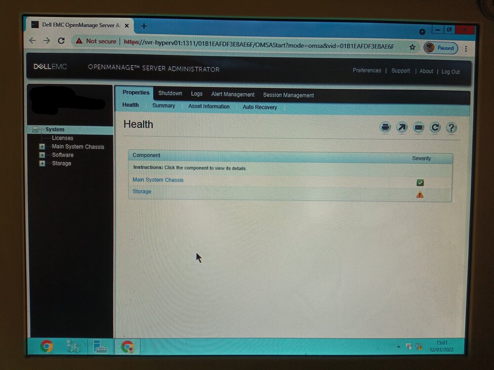

Got in to find sole host server running, but no VMs would launch. A reboot showed a Lifecycle error (now fixed) and that 1 of 2 virtual disks was degraded. I have identified the problematic physical disk, but the problem remains.

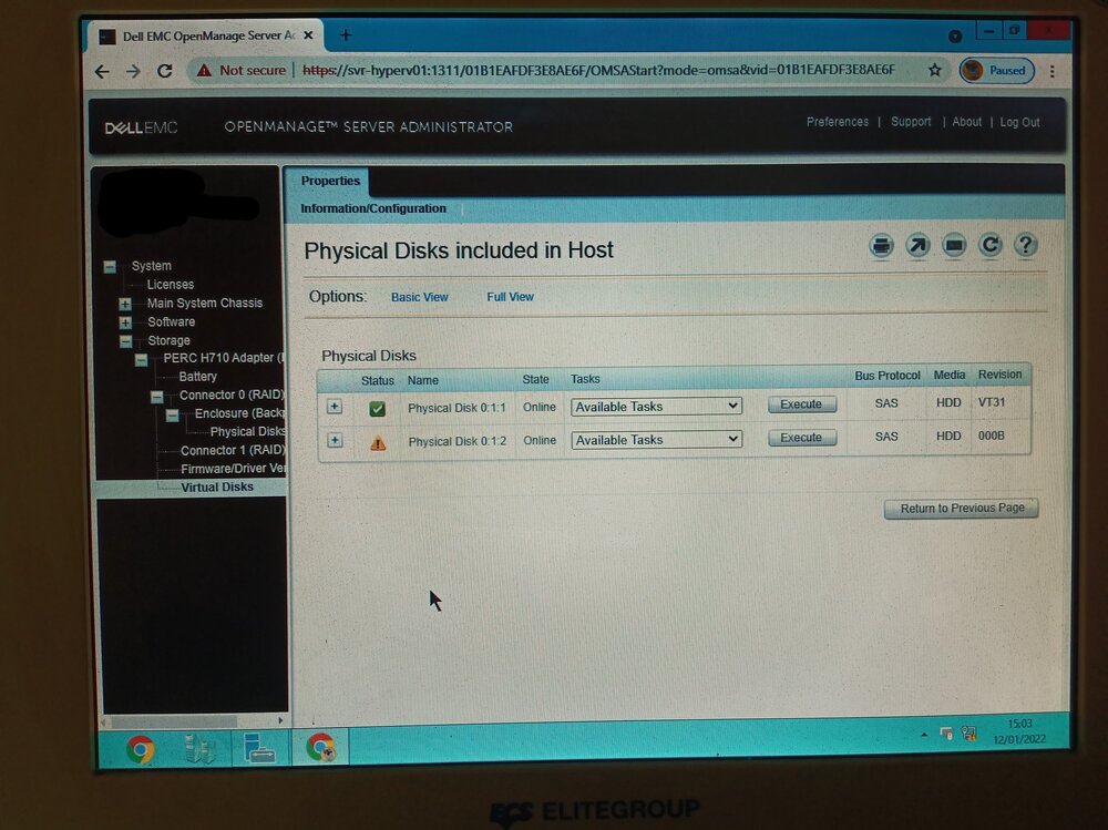

Slots 0 and 2 appear to be the OS disks in RAID 1; slots 2 and 3 to 5 the storage disks that contain the VHDs etc. in RAID 10 but this shot doesn't jibe with that.

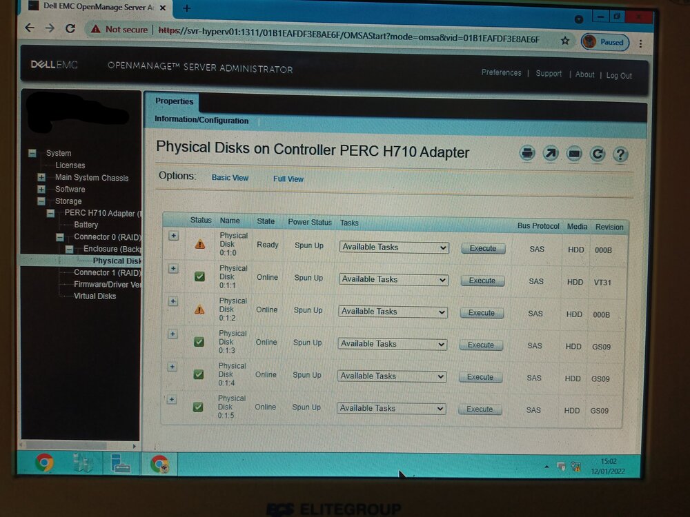

Though this does?

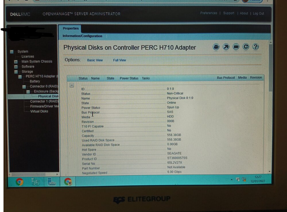

Slot 0 details
Slot 2 says "ready" and "spun up".

Main page

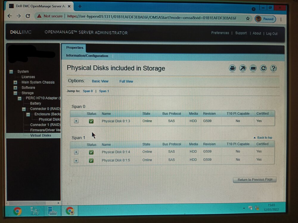

From your screenshots, image one is saying that the OS disks are 1 and 2, image two is just showing you all drives connected to the controller and has nothing to do with which drive is in which array, third image shows that there's a non-critical warning with that drive, but the problem is not shown in the image. Your storage array is just disks 3-5 according to the fourth image.

After more fiddling I have determined that disks 0 and 1 are the OS. Well were, after some more fiddling by me, 1 became a foreigner and importing it messed both up. Now it boots off disk 1 and 0 is the foreigner.
I'm wondering if the problem is because only 3 of the disks in the RAID 10 are "in the gang" and I can see no way to include the fourth, This MAY be because it was probably the original 0.5TB and the others have been replaced over the years and are 1TB? But where is disk 6?

Both of those disks with the errors are version code 000B which normally means non-supported (e.g. Not Dell branded/coded drives) which is likely why they're erroring in that sense
If you wanted to test if that's the error, and you have OSMA 8.5+ you could turn off the flag in stsvc.ini in program files temporarily to test it if resolves the flags
