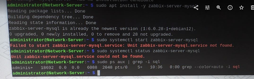

I've had no hands on with Pi's so take with salt..
try something like ps aux | grep -i sql
(i'm assuming an sql not mariadb service)
Hopefully you will see something like :
sql 2570457 10.4 3.6 4988572 602036 ? Ssl Feb23 7198:35 mysqld --character-set-server=utf8mb4..................
to at least confirm it's running.

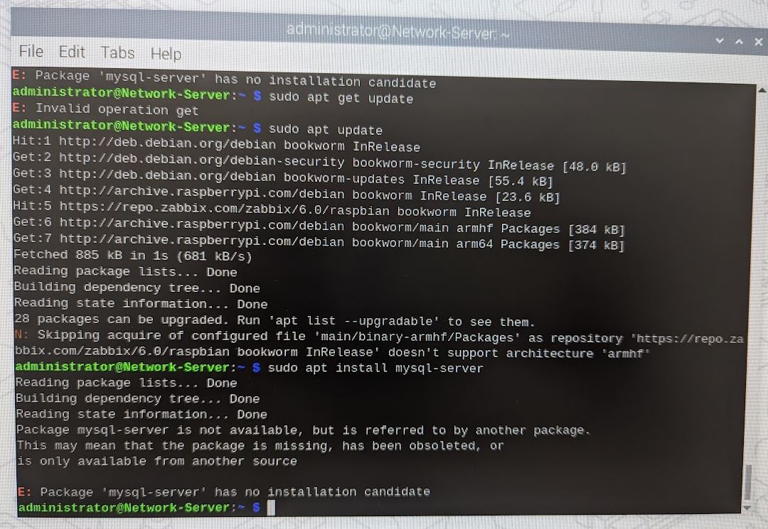

Oh! heh... I was just installing Pi OS on a quick vm to take a look. but reading that forum makes sense.. ( I Use docker under linux so I have it setup different in containers ) so if that other forum is correct you'll need to install a SQL instance to run it on. Like that other post mentions there's a few types but all the main ones will work and lot of people will have different opinions, the basic MySQL can be installed with
apt install mysql-server
Which should guide you through setting up the first user etc which you can use in the following Zabbix steps

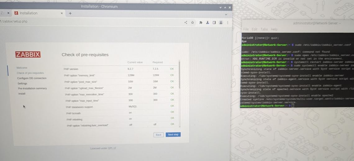

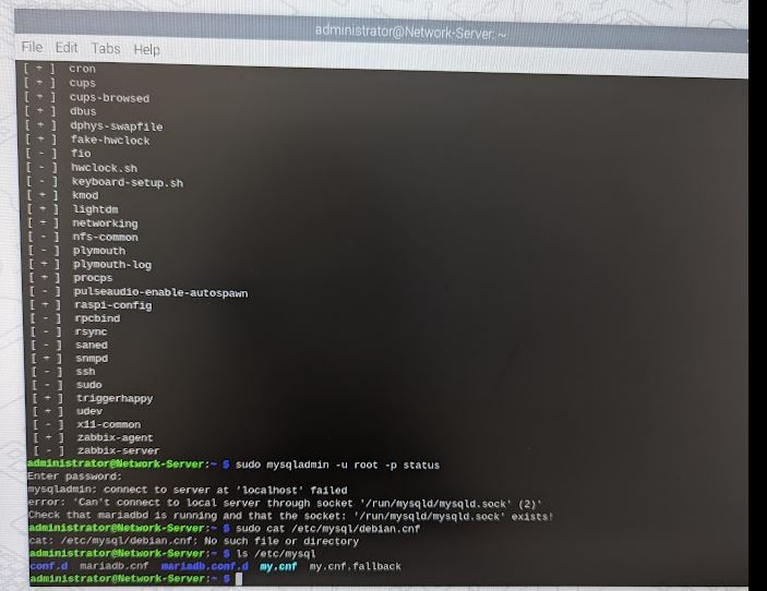

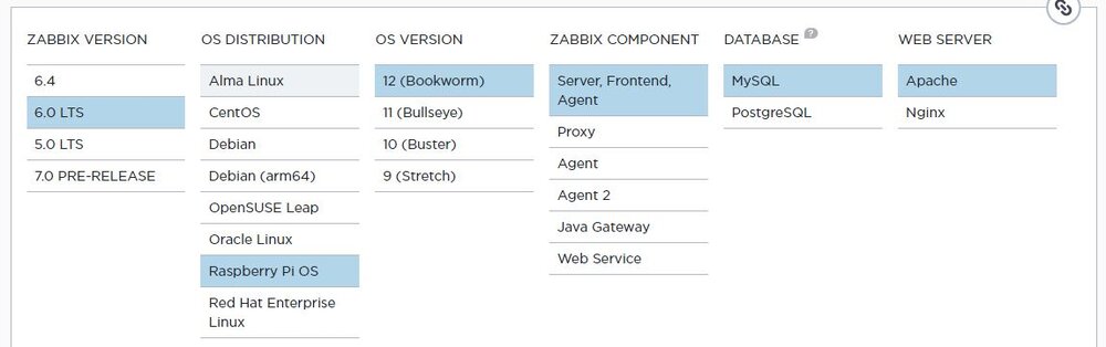

I just followed that guide on a pi vm and had similar steps. It does look like it installs MariaDB along with Zabbix Server but doesn't start it. I had the same error (about socket) until I did systemctl start mariadb
edit: oh sure now let me attach the image :p
Edited by tdk1069
Well that was an effort!
so did you just type:
after
apt install zabbix-server-mysql zabbix-frontend-php zabbix-apache-conf zabbix-sql-scripts zabbix-agent
as you followed the guide?
thank for all your help!
For me personally yes. You can see it in my 2nd screenshot (about 3 lines down) I'm wondering if you installing mariadb again forced it to start. Who knows :) but that would be why it didn't list anything on ps aux|grep -i sql.... it doesn't have sql in the name, now you can do ps aux|grep mariadb..
