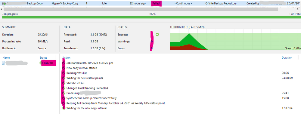

Here's the status of one of our backups. As you can see, it shows as "failed" in the list view, but the detail shows a status of "success", 1 success and no warnings or failures, and all the actions have green ticks. So, did it succeed or did it fail?!
That is a pass, where it shows fail is the previous result. Have the same issue daily with my current setup in process of migrating to new setup so hopefully Veeam will fly through.
Why would I want to know the previous result? Surely the most recent result is the one I'm more likely to be interested in.

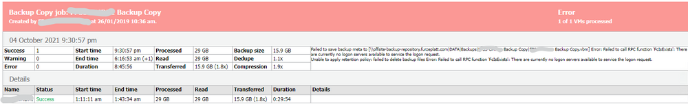

If you right click on the job and click report it will give you more information.
More information, but no more clarity! I can see the error it threw but it still says "success".
