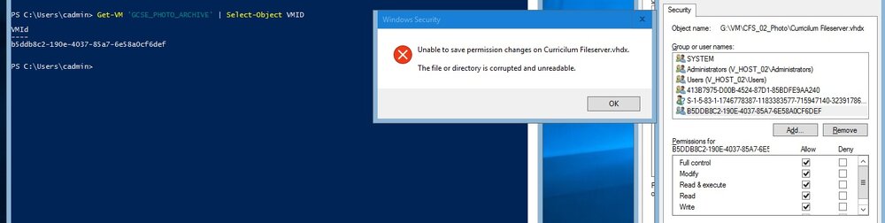

All seems to match up apart from on the VHD which has a missing GUID which I assume is from the old VM id before I re-created it.
The permissions are screwed on some for example this shows the vm having only read permissions to the VHDX file:
When I try and give the VM id full control I just get this error:
Is there anyway to reset the permissions on the VM's without rebuilding Hyper-V on the server?
That SID isn't an old one - S-1-15-3-1024-2268835264-3721307629-241982045-173645152-1490879176-104643441-2915960892-1612460704 etc that's a prebuilt HyperV one that should exist
You should be able to use icalcs to reset the one you're talking about, but if you're missing the other HyperV SID it looks like something odds happened to that server...
icacls "E:\...\Disk-C.vhdx" /grant "NT VIRTUAL MACHINE\MY_VM_GUID":(F)
Thanks Steve, will do some research on how to add that SID back in if possible otherwise I may have to remove hyper-v and reinstall it.
