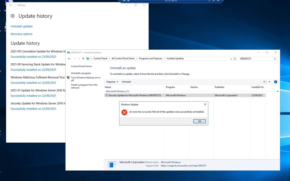

I have tried repeatedly removing update, it is not coming off. Any ideas? I am getting hounded by people every day because they cannot print.

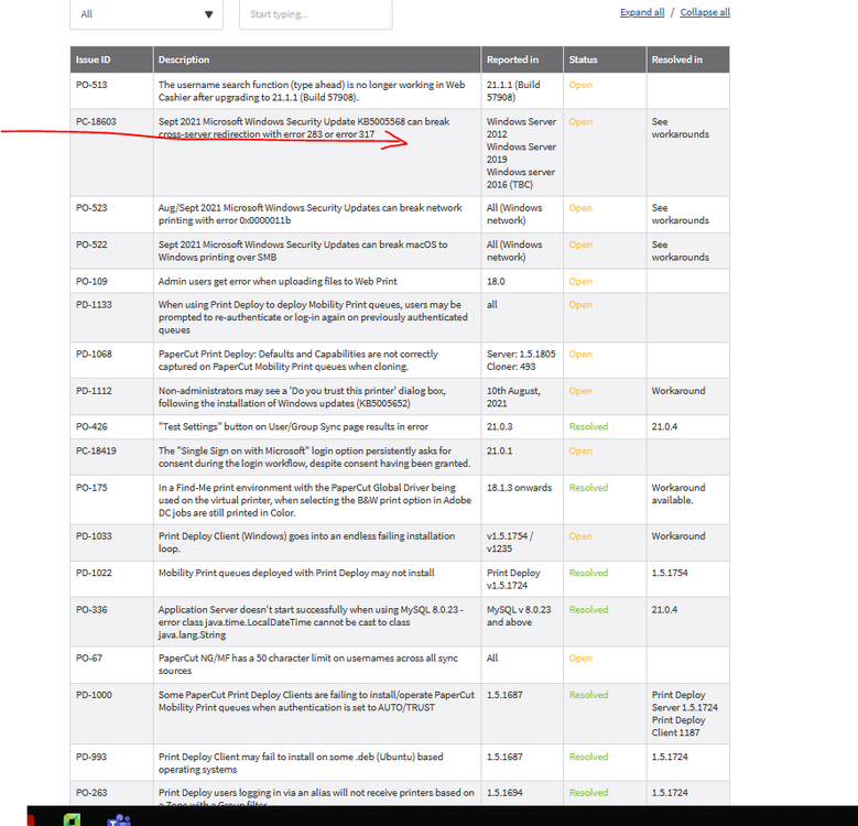

[ATTACH=CONFIG]63185[/ATTACH]
I suspect they've recently picked up the problem updates. We were having this on all of our clients even though none of the drivers have been changed for several months. Managed to bypass it in the end but now most clients are just getting an error with the Sept 14th patch, which just shows 'access denied' 'printer unavailable/offline' or 'error message unavailable'.

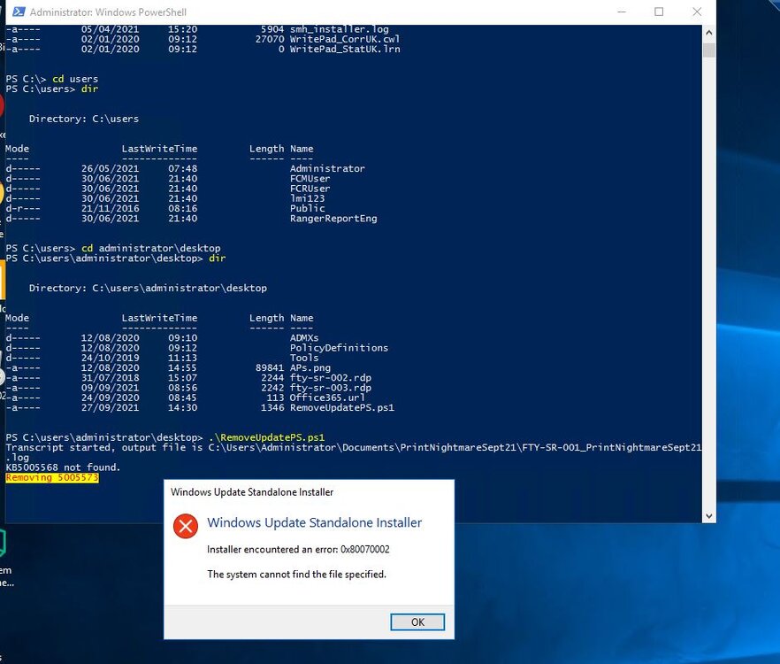

Thank you for the helpful post and script.

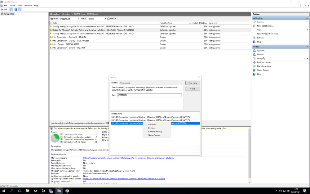

I have run it and got the following:
[ATTACH=CONFIG]63188[/ATTACH]
The log file is showing the following...
Not sure why it would not be able to find the file specified. KB5005573 is still showing as installed on Installed Updates.
What a mess. :mad:

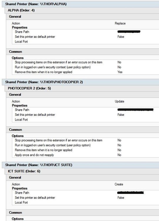

Printers deployed via GPP to users
Point and Print restrictions enabled (as in many other posts) with 'RestrictDriverInstallationToAdministrators' regedit set to 0
How large is your estate and can you manually install printers as Administrator to keep the most vocal quiet and give yourself some peace and time to think and ease the stress?

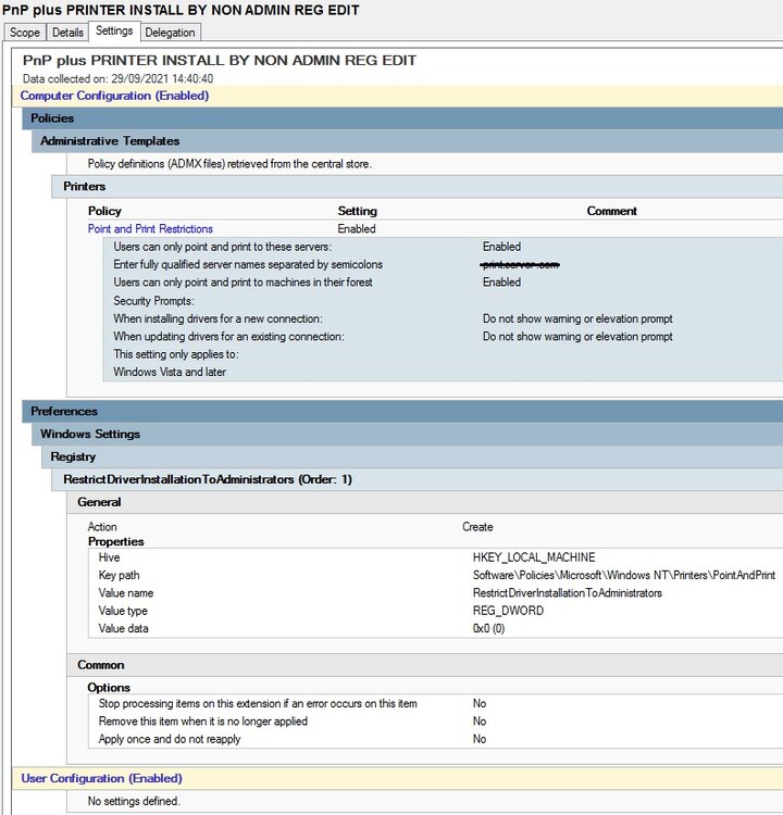

[ATTACH=CONFIG]63227[/ATTACH]
[ATTACH=CONFIG]63228[/ATTACH]
All of these deploy and install fine, tested on a client with a fresh install of LTSC 1809 with Sept update. I use this PS script on the machine each time I test it to remove the drivers and package (a bit clunky and not as automated as I'd like, but the driver removal is manual so you can choose):

The three printers are listed in there and will apply for all computers and locations in the domain so everyone gets the same ones.
The printer connection paths are listed as \\servername\PrinterName.
I tried to add the RestrictDriverInstallationToAdministrators reg to this GPO but it has made no difference at all.
I have spent hours trying to remove KB5005573 on this server and it just will not remove.

Haven't had time to go through everything in your post and I'm no expert for sure...
The reg entry should be a DWORD not a REG_SZ so see if changing that works first... and I also seem to remember the reg edit being dependant on Point and Print restrictions being set in the GPO (someone correct me if I'm wrong).
Do you have these set?
EDIT: Disclaimer - Just to say this is not 'best practise' or 'recommended' by MS... I'm not entirely sure what they expect us to do if someone has hundreds of workers and you are supporting them remotely or whatever...? You can't just pop down or RDC in to that many computers and install them yourself as an admin...

I did manage to search for KB5005573 and it found it 3 times. Twice for Windows 10 and once for Server 2016. I removed the entry, but still, server 2016 will not remove the KB5005573 update.

Rather than remove the entry (I'm not really sure what you mean), it would have possibly been better to 'Approve for Removal' and decline (although that might give you other problems when you want it back eventually, not sure if you can re-import declined updates as I've never done it - although the next cumulative might be here by then)?

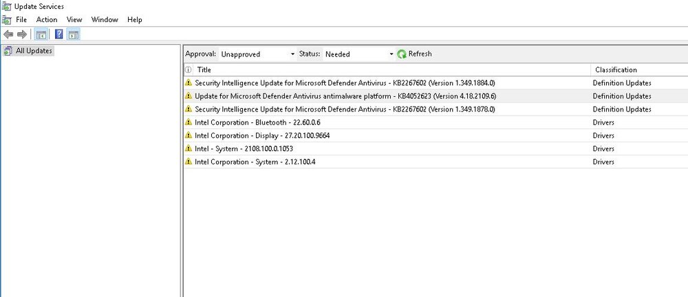

Have you tried 'creating' other views (right click on 'All Updates' and choose 'New Update View')?
Also you can choose the drop down 'Approval' and choose something else like 'Any Except Declined' and status 'Failed or Needed' (or even 'All')
[ATTACH=CONFIG]63278[/ATTACH]
[ATTACH=CONFIG]63279[/ATTACH]

Thanks for your post.
By Remove, I mean...
I can either Approve or Decline it. There are no other options that will be of use.
Yes, tried other views, but just get the same view whatever I try.

Does it matter if the Windows 10 clients have KB5005573 installed? My understanding is that if the server has it installed, that is why users can't print and are asked to install drivers or authenticate?
Yes, it is the same process for 'Approve' and 'Approve for Removal' - after you choose 'Approve' the dialogue box in my previous post will come up and (if it has been approved previously I think) the option for removal (if it is possible - some aren't) will be available to select.

OK, the workarounds related to the September 2021 patch are both the same and are what was mentioned earlier in the thread:
Further workaround:
An additional temporary workaround is listed below, which allows customers to install the security fix. As detailed on the Microsoft KB, one temporary alternative to get printing working again is (on the Windows Print Server) to:
Add a new registry key: HKEY_LOCAL_MACHINE\SYSTEM\CurrentControlSet\Control\Print\RpcAuthnLevelPrivacyEnabled (type DWORD)
Set the new key value to 0.
Restart the Print Spooler service.
This should allow cross-server redirection to work as before.
Thanks for this fix :)
:eek:
One of my site printing start breaking and surely the September update caused this issue. After uninstalling the September update and printers are back to normal.
As the security team keeps pushing to have the latest patches on servers and September update again schedule to install again:confused: I have applied reg to fix to as workaround.:rolleyes:
