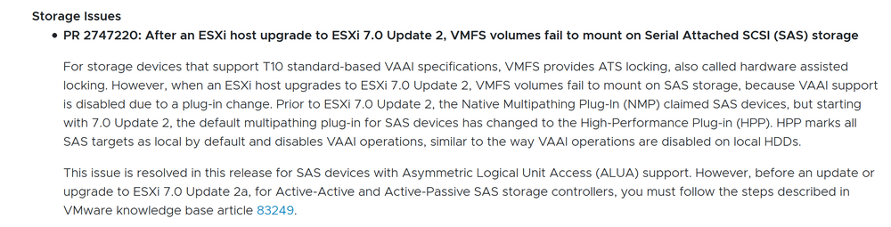

Has anyone had any major problems with esx 7? I've upgraded our two hosts to esx 7 update 2a and it seems to have completely broken snapshot functionality. I only noticed when our Veeam jobs all failed and now running a snapshot seems to completely lockup the VM after a few minutes which also can't be cancelled.

ESX 7U2 tho, they changed the way that it sees SAN storage which meant on the host I updated would try to mount it as local storage/lock the SAN which meant it couldn't see the VMS properly. Had to revert to 7U1 for now.
Odd, I moved from 6.7 to 7 update 2a. Have checked it's seeing the SAN properly and not making it as local, I just can't create a snapshot. I've got a remote sesison with vmware support tomorrow morning, so fingers crossed that sheds some light. Is very annoying though as none of our backup jobs can run until this is fixed. Rebooting vcentre cleared the task from the UI, but something's still stuck on the hosts.
