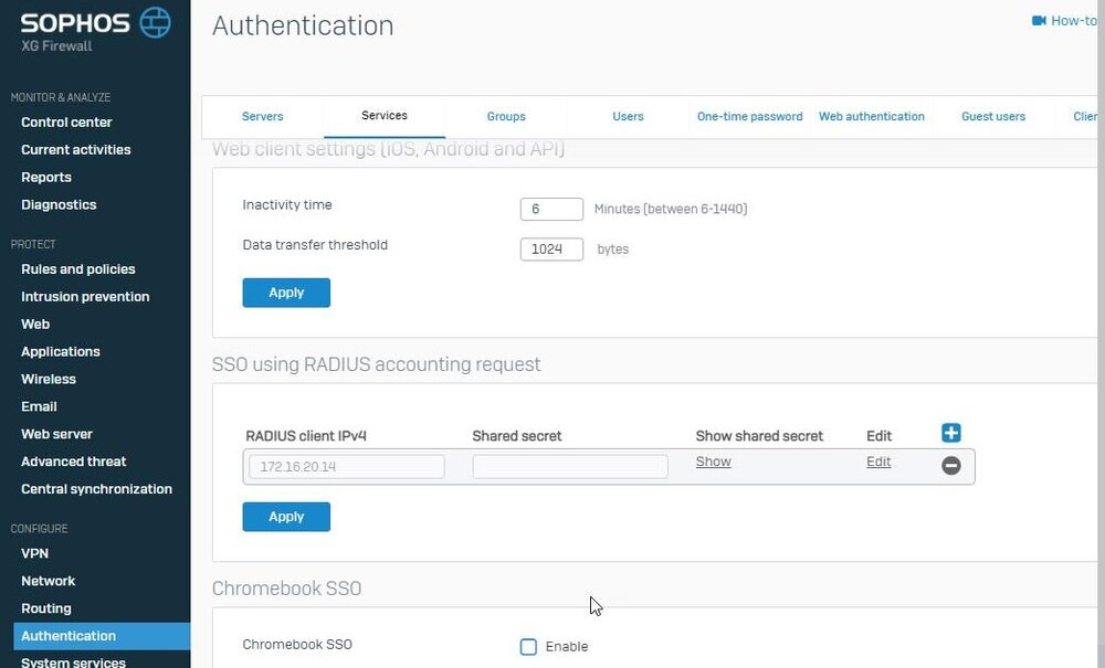

Do you have the IP address of each Unifi AP added under Authentication -> SSO using RADIUS account request on the XG?
No, I just have the NPS server listed there as that is where the accounting is being forwarded from.
Should I put the APs in there and have accounting sent straight from the APs to the XG like that?

If using NPS (just to check), you need to add the XG as a remote RADIUS server and then pass RADIUS accounting to it:
Then configure your XG:

So that's how I have got it set and in the connection request policies, I have a wireless connections policy which forwards the accounting to the Sophos XG (Remote RADIUS Server Group).
It's just a bit strange how it will randomly drop auth on the Sophos and pick it back up again.
