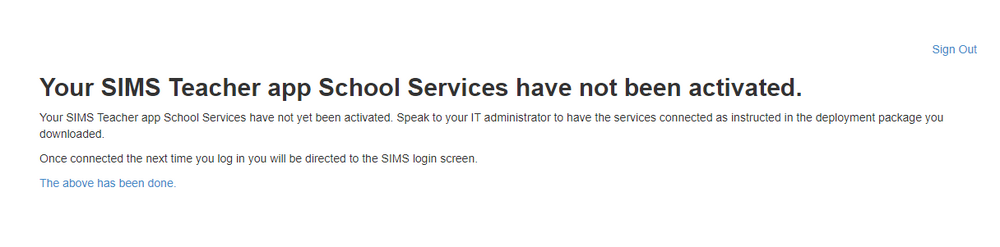

This has been going on for the past week since coming back from lockdown.
For those Teacher that do manage to get into the Teacher App they have no classes to show and yet they have the group permissions of Class Teacher.
Our Teachers App Console is so flaky that it is becoming impossible to take the registers using the Teacher App.
I get the standard reply from Sims Hosted Support and that is to check the credentials see below:

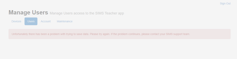

Attached are the screenshots of what I get.
Any ideas?
Thanks
